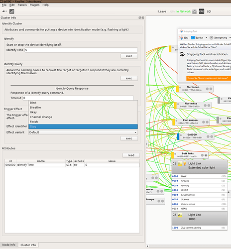

I had similar behavior with hue lights and it was related to the alert & effect channels. When one of them had gotten a value other than NONE in the past my lights flashed when I switch them on.
Took me some time to see that connection, but after I made sure that I had send NONE to these channels the problem was gone.
Could your problem be related to that?
