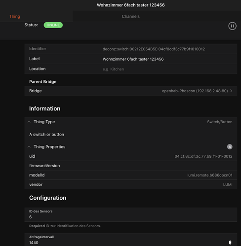

since my upgrade to OH3 the Sensor Pipeline from my 6 Button Aqara Switch is not working.
I have deleted and re learned on the Deconz side,
then re integrated into OH through Auto Discovery and mapped it to my file based items.
The Sensor Switch is shown in openhab as GONE (Offline - not rechable).
In Deconz the Switch is shown available and could switch Lights (if adapted in an Group).

Hi J-N-K,
I have updated the binding to last of today.
The problem still occures.
I reseted the deconz gateway and uninstall and install the deconz binding.
Before that I’ve deleted the all deconz things.
Then I have re install the binding and re integrate the things, but the problem still occurs.
I had the following error if i trigger the switch.

it still doesn’t work.
If I learn a new 6switch on to deconz following happens:
2021-01-24 17:58:40.140 [TRACE] [nternal.netutils.WebSocketConnection] - Websocket$1611506897253-1 received raw data: {“e”:“added”,“id”:“6”,“r”:“sensors”,“sensor”:{“config”:{“battery”:null,“on”:true,“pending”:[“mode”],“reachable”:true},“ep”:1,“etag”:“48a0dc86c083f0e98ecf94353eb1cab8”,“id”:“6”,“lastseen”:“2021-01-24T16:58Z”,“manufacturername”:“LUMI”,“mode”:1,“modelid”:“lumi.remote.b686opcn01”,“name”:“lumi.remote.b686opcn01 6”,“state”:{“buttonevent”:null,“lastupdated”:“none”},“type”:“ZHASwitch”,“uniqueid”:“04:cf:8c:df:3c:77:b9:f1-01-0012”},“t”:“event”,“uniqueid”:“04:cf:8c:df:3c:77:b9:f1-01-0012”}
2021-01-24 17:58:40.144 [DEBUG] [nternal.netutils.WebSocketConnection] - Couldn’t find listener for id 6 with resource type SENSORS. Either no thing for this id has been defined or this is a bug.
2021-01-24 17:58:46.194 [TRACE] [nternal.netutils.WebSocketConnection] - Websocket$1611506897253-1 received raw data: {“e”:“changed”,“id”:“6”,“name”:“OPPLE switch 3-gang”,“r”:“sensors”,“t”:“event”,“uniqueid”:“04:cf:8c:df:3c:77:b9:f1-01-0012”}
2021-01-24 17:58:46.197 [DEBUG] [nternal.netutils.WebSocketConnection] - Couldn’t find listener for id 6 with resource type SENSORS. Either no thing for this id has been defined or this is a bug.
