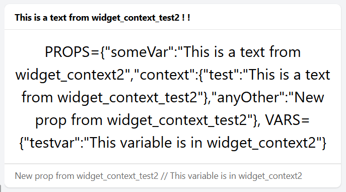

Then, call this widget from another widget. Here you need to ensure that you “pass on” the original props to a new prop, so you can access them from the derived widget:
uid: widget_context_test2
tags:
  - development
props:
  parameters:
    - default: This is a text from widget_context_test2
      label: Test
      required: false
      type: TEXT
timestamp: Jan 10, 2026, 2:36:38 AM
component: widget:widget_context2
  context: =props
  anyOther: New prop from widget_context_test2
  default:
    - component: oh-label-card
        title: =props.context.test+fn.duplicate(' !')
        footer: =props.anyOther+' // '+vars.testvar
        label: ='PROPS='+JSON.stringify(props)+', VARS='+JSON.stringify(vars)
your result is something like this:
A few comments:
  1. the name ‘context’ was just chosen by me, you could also name this any other way, say banana. In such case, you would access the props by changing title to =props.banana.test
  2. anyOther is treated like a new prop of the widget_context_test2 widget (just like context). For both, the value can be specified just like it was a variable.
  3. In the result you can see the JSON objects props and vars (both predefined by the system. In vars, you can see the variable that was initiated in the widget_context2 (original), so you could access it in here as well.
  4. You can access functions in widget_context_test2 that are defined in widget_context2 which I demonstrated with duplicate().
