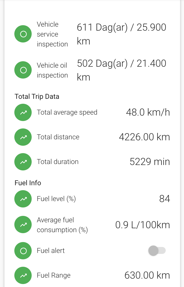

first data:
Milage missing
fuel consumption wrong
Average Fuel Consumption 0.8 L/100km
Last Trip Data Fuel Consumption 0.9 L/100km
(i would love to have this consumtion)
New binding jar again, original post updated. Please use that one! :slight_smile:
Milage missing
Milage = totalTripDistance channel, it is fetched by the get-latest-trip-statistics API request. Search in the logs for Last trip.
Fuel consumption is not calclulated by the binding, it is also fetched from VW We Connect portal.
Can you compare the figures with the portal or the App?
