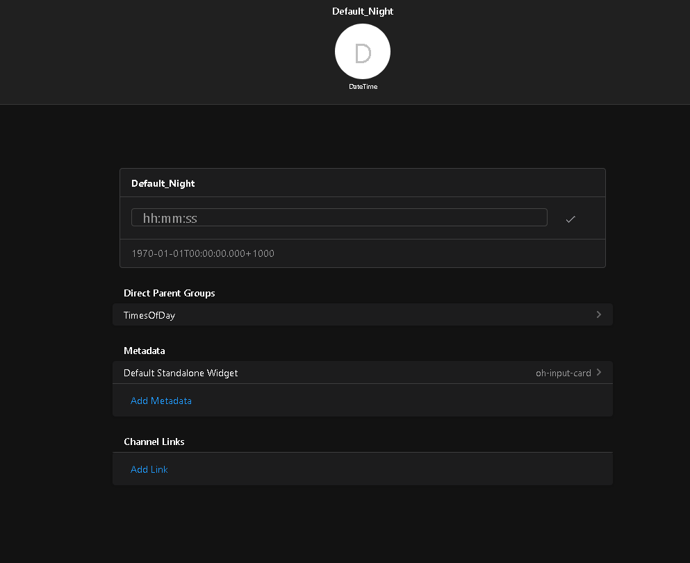

I don’t believe its related to persistence because these items are brand new, related to the java version of the Time of Day rule by Rich
There is no persistence configuration for these items (Default_Bed) - the ones set by the binding Astro are fine. It’s the one that use the input-card. My understanding is what once this metadata is set on the item, it should stay across a reboot.
Whats the purpose of this then on an item which has no binding channel?
Makes no sense to me to set meta data that set its time, to not carry across. I dont see the point of the entire post made by Rich when I could have easily just set the values to 1, persisted it for restore on startup. The whole metadata thing for this purpose only doesnt seem useful.
Anyway, ill add them to persistence.

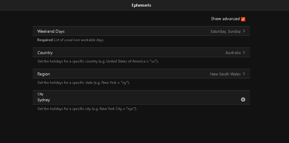

Once that’s done the rule runs @rlkoshak but the times for Default_Night etc are incorrect, despite me having the correct Ephemeris.

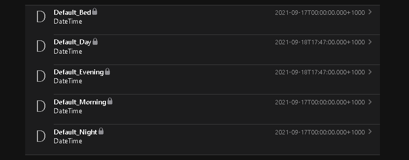

Screen shots are not all the helpful in general. If you have .items files just post those. However I can see that:
the DateTimes not linked to the Astro Channel are all set to midnight
the DateTimes except for Astro are all set to yesterday
This means either the rule didn’t run or it didn’t trigger to run last night a little after midnight. The rule looks at the date for all the Items and if the date is for yesterday it advances the date to today. This also means that your attempts to initialize the Item were not successful. I’m pretty sure you don’t want BED, EVENING, and MORNING to happen a the same time.
Reinitialize the Items not linked to Astro to their proper times. Watch the logs to make sure you see the rule run. If it didn’t run trigger it manually.

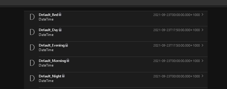

After putting arbitrary numbers in those non linked items, i see this:
05:36:29.884 [INFO ] [.openhab.model.script.Rules.TimeOfDay] - Today is a weekend day.
05:36:40.901 [INFO ] [core.model.script.Subfloor Humidity: ] - 98
05:36:59.953 [INFO ] [.openhab.model.script.Rules.TimeOfDay] - The current time of day is DAY
05:37:02.196 [INFO ] [.openhab.model.script.Rules.TimeOfDay] - Today is a weekend day.
^C~ openhab>

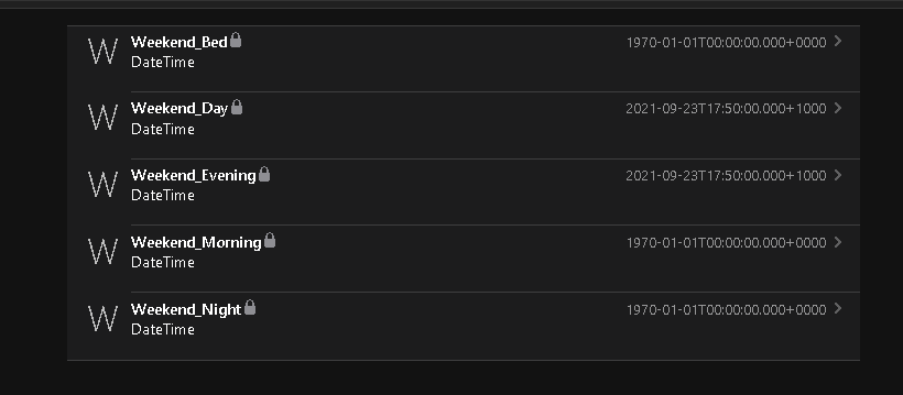

Right! Ok, added the new items, initalised and reran
05:51:00.466 [INFO ] [.openhab.model.script.Rules.TimeOfDay] - Today is a weekend day.
05:51:00.608 [INFO ] [.openhab.model.script.Rules.TimeOfDay] - Moved Weekend_Morning to today.
05:51:00.615 [INFO ] [.openhab.model.script.Rules.TimeOfDay] - Moved Weekend_Night to today.
05:51:00.619 [INFO ] [.openhab.model.script.Rules.TimeOfDay] - Moved Weekend_Bed to today.
05:51:30.626 [INFO ] [.openhab.model.script.Rules.TimeOfDay] - The current time of day is MORNING
05:51:31.666 [INFO ] [.openhab.model.script.Rules.TimeOfDay] - Today is a weekend day.
05:51:31.674 [INFO ] [.openhab.model.script.Rules.TimeOfDay] - Moved Weekend_Morning to today.
05:51:31.682 [INFO ] [.openhab.model.script.Rules.TimeOfDay] - Moved Weekend_Night to today.
05:51:31.684 [INFO ] [.openhab.model.script.Rules.TimeOfDay] - Moved Weekend_Bed to today.
Looks better Rich! Lets see tonight how that goes.
