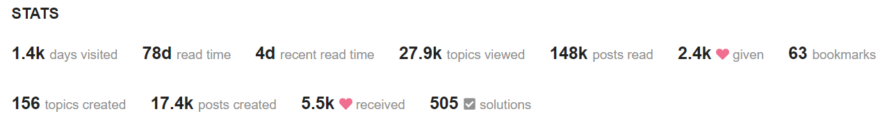

I also don’t recall being confrontational to any other posting you’ve made. But I make so many posts:
 ![image](https://community-openhab-org.s3.dualstack.eu-central-1.amazonaws.com/original/3X/4/7/47337ed25645056a9d26997e1e280b6600f15cd5.png)
maybe I’m forgetting. Though you are the only person who seems to have a problem with my posts. Hmmm, what’s the common denominator?
But as you wish. Consider yourself silenced. I’ll see no more posting from you.

Are you really that passive/aggressive that you had to post your stats to some how show that you are superior? Do you really not realize that your reply in itself was confrontational?
