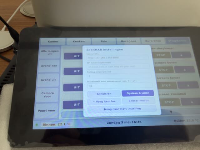

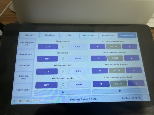

I installed openHAB on my NAS and connected it to my MyHome Server 1. Once that was working, I built my own lightweight interface as a replacement for the Legrand control app and Pi 7" screens.
👉 The idea was simple:
Create a clean, fast, and fully customizable UI that works on any screen. I found the OpenHab UI quit restricted. So with the help of claude desiged a HTML page
So I made:

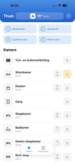

  • a web-based dashboard (PWA) for daily use
  • a dedicated UI for a Raspberry Pi 7" wall screen (kiosk style)

  • openHAB = the “brain” (controls lights, shutters, heating, etc.)
  • My UI = the “screen” (buttons, rooms, controls)
  • Communication via openHAB REST API
  • Updates every few seconds → near real-time feedback

✔ Works on any device (tablet, wall panel, phone)
✔ Much more flexible than the standard app
✔ Fully customizable layout per room
✔ Perfect for wall-mounted touch panels

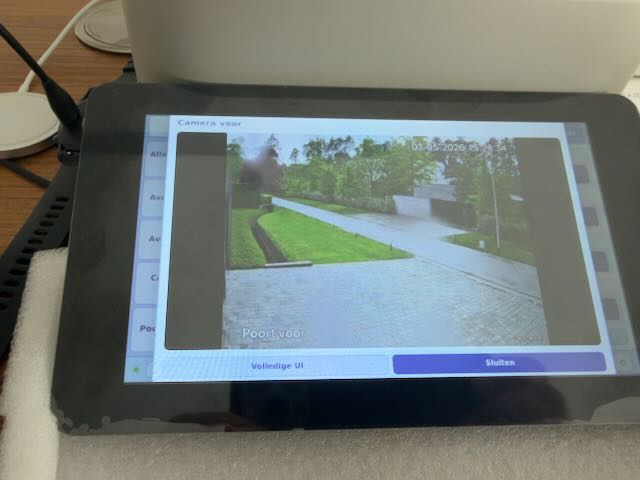

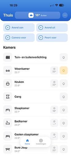

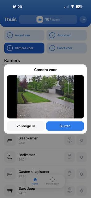

My app (is a PWA) is based on the design of the Legrand app but with additonal functionality like integrating my camera
