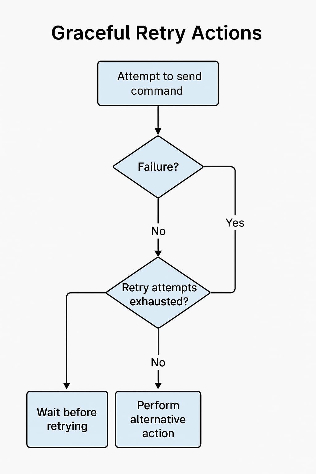

Design Pattern(?): Graceful Retry Actions
Design Pattern: Graceful Retry Actions
Problem: An actuator sometimes does not respond to commands (e.g., MQTT device offline).
Standard rules then produce error messages or get stuck.
Solution:
  • Define a rule that sends commands with a retry mechanism.
  • Use timers to control repetitions.
  • After a configurable timeout, an alternative action (e.g., notification) is triggered.
Advantages:
  • Robust handling of network issues or unstable devices.
  • Decouples error handling from normal workflow.
1. Concept
Goal: A command should be sent to a device. If the device does not respond (e.g., offline), we retry the command until either:
  • the device responds, or
  • a maximum number of attempts / timeout is reached.
Optionally, an alternative action can occur after the timeout (e.g., notification, logging, alarm).

    devices.forEach [ device |
        retryCounts.put(device, 0)
        val int initialInterval = INITIAL_INTERVAL
        val Timer t = createTimer(now.plusSeconds(0), [ |
            try {
                // Online check: device is reachable only if it has a valid state
                if(items.get(device) !== NULL) {
                    events.sendCommand(device, ON)
                    logInfo("MultiRetryOnline", device + " command sent successfully!")
                    retryTimers.get(device)?.cancel()
                } else {
                    throw new IllegalStateException("Device " + device + " is offline")
            } catch(Throwable t) {
                val int count = retryCounts.get(device) + 1
                retryCounts.put(device, count)
                logWarn("MultiRetryOnline", device + " attempt #" + count + " failed: " + t.message)
                if(count < MAX_RETRIES) {
                    val int nextInterval = Math.min(initialInterval * (2^count), MAX_INTERVAL)
                    logInfo("MultiRetryOnline", "Next attempt for " + device + " in " + nextInterval + " seconds")
                    retryTimers.get(device)?.reschedule(now.plusSeconds(nextInterval))
                } else {
                    logError("MultiRetryOnline", device + " max retries reached!")
                    sendNotification("admin@example.com", device + " could not be switched ON!")
        retryTimers.put(device, t)
DSL Explanation:
  • items.get(device) !== NULL checks if the actuator is online (alternatively, DeviceStatus items could be used).
  • Offline errors trigger a retry.
  • Exponential backoff is applied as before.

Dynamic Multi-Device Retry with Online Check and Exponential Backoff
Advantage: You no longer need to manually maintain a device list—the rule dynamically retrieves actuators from a group or a configured item list.
1. Rule DSL: Dynamic Devices with Retry, Backoff, and Online Check
var Map<String, Timer> retryTimers = newHashMap
var Map<String, Integer> retryCounts = newHashMap
var final int MAX_RETRIES = 5
var final int INITIAL_INTERVAL = 5 // seconds
var final int MAX_INTERVAL = 60    // seconds
rule "Dynamic Multi-Device Retry with Backoff and Online Check"
    Item RetryTrigger changed to ON
    // Dynamically fetch all devices from a group
    val devices = GroupDevices.members.filter[i | i !== NULL].map[i | i.name]
            try {
                // Online check: item must have a valid state
                    logInfo("DynamicRetry", device + " command sent successfully!")
                } else {
                logWarn("DynamicRetry", device + " attempt #" + count + " failed: " + t.message)
                    logInfo("DynamicRetry", "Next attempt for " + device + " in " + nextInterval + " seconds")
                } else {
                    logError("DynamicRetry", device + " max retries reached!")
DSL Explanation:
  • GroupDevices is an openHAB group containing all retry-capable actuators.
  • members.filter[i | i !== NULL].map[i | i.name] generates a list of active devices.
  • Exponential backoff is calculated individually per device.
  • Alternative action (notification) is triggered on max retries.

  • Retry parameters
1.1 Trigger Item
Switch RetryTrigger "Retry Trigger"
  • Set to ON to start the retry process.
1.2 Device Group
Group RetryDevices "Devices to Retry"
  • Collect all actuators to retry in this group.
  • Example:
Switch LightSwitch "Living Room Light" (RetryDevices)
Switch HeaterSwitch "Heater" (RetryDevices)
Switch FanSwitch "Fan" (RetryDevices)
1.3 Retry Parameters
Number RetryMaxAttempts "Max Retries" <number>
Number RetryInitialInterval "Initial Interval (s)" <time>
Number RetryMaxInterval "Max Interval (s)" <time>
String RetryAlternativeAction "Alternative Action"
  • RetryMaxAttempts e.g., 5
  • RetryInitialInterval e.g., 5 seconds
  • RetryMaxInterval e.g., 60 seconds
  • RetryAlternativeAction e.g., "Notify admin"
2. Python (Jython) Version
  1. Save the Python template code in conf/automation/jsr223/python/.
  2. Example filename: multi_device_retry.py
  3. Content: see Python Template above.
Test:
  • Turn RetryTrigger ON
  • Observe logs (openhab.log) and notifications (NotificationItem)
3. Rule DSL Version
  1. Save the DSL template code in conf/automation/rules/.
  2. Example filename: multi_device_retry.rules
  3. Content: see DSL Template above.
Test:
  • Check logs and notifications
4. Adjust Parameters
Item Purpose
RetryMaxAttempts Number of retries per device
RetryInitialInterval Start interval for retry in seconds
RetryMaxInterval Maximum interval for exponential backoff
RetryAlternativeAction Message on max retries (e.g., "Notify admin")
  • Adjust directly via Items; no code modification required.
5. Extension Possibilities
  • Device-specific intervals: Create additional Items or maps for different retry parameters per device.
  • Conditional retry: Check status items to retry only specific devices.
  • Logging & monitoring: Use dashboard or notifications to immediately identify failed commands.
6. Advantages
  • Fully dynamic and configurable.
  • Supports any number of devices simultaneously.
  • Online check prevents unnecessary retries.
  • Exponential backoff reduces network load.
  • Alternative actions reliably notify for devices permanently offline.
I think these examples are based on a false assumption. Did you test this code?
You will never get an exception when you send a command to an Item from a rule (unless the Item doesn’t exist in the first place). So you will never get into the catch where the retry is implemented.
What you have to do is wait for a little bit (i.e. create a timer) to see if your Item changed to the expected state in response to the command and only if it didn’t to retry. This also requires the Item to have autoupdate set to false so that it doesn’t just automatically change in response to the command and instead waits for the device to report back the changed state.
It gets even more complicated for Item types where the commands and the states do not match. For example, if you send INCREASE as a command to a Dimmer Item, the Item’s state will never be INCREASE, it will be an integer between 0 and 100. You can possibly infer that if the state changed at all it changed in response to the INCREASE command. But if the Dimmer was already at 100, it won’t change even if the command was received.
This definitely could become a design pattern but as currently implemented this code does nothing. Neither the Rules DSL nor the Jython examples will ever retry the command.
If implemented correctly, it would have somewhat limited use to cases where the device will always change state in response to every command. So Dimmers and Rollershutters and Color Items would only work most of the time.
This code is untested, but the following JS Transformation theoretically could be used in a Profile in the Item command to Channel direction to implement a retry, with the limitations discussed above. Note this code requires OHRT.
(function(data, item, delay, maxRetries) {
  const {LoopingTimer} = require('openhab_rules_tools');
  const timer = cache.private.get(item+'_timer', () => LoopingTimer());
  const retryCommand = cache.private.get(item+'_command', () => data);
  const beforeState = cache.private.get(item+'_beforeState', () => items[item].state;)
  // timer is runnining, this is a retry
  // pass the data through
  if(!timer.hasTerminated()) {
    return data;
  // timer is running but data is different from retryCommand, this is an override
  // cancel the timer
  else if(!timer.hasTerminated() && data != retryCommand) {
    timer.cancel();
  // start the looping timer to retry the command
  timer.loop(() => {
    let numTries = cache.private.get(item+'_numTries', 0);
    // Item has not changed and we haven't reached max retries
    if(items[item].state == beforeState && numTries < maxRetries) {
      items[item].sendCommand(data);
      cache.private.put(item+'_numTries', nuTries++);
      return delay;
    // Item state finally changed or we reached max retries, exit the loop
    else {
      cache.private.remove(item+'_numTries');
      cache.private.remove(item+'_command');
      cache.private.remove(item+'_beforeState');
      return null;
  }, delay, item);
})(input, item, delay, maxRetries)
You need to pass item, delay (anything supported by time.toZDT()), and maxRetries as command line arguments using URL encoded carguments. See the docs for details. For example, if the above were added through the UI:
config:js:retry?item='MyItem'&delay='PT1S'&maxRetries=3
The above will retry the command sent to MyItem every second up to three times.
Again, I’ve not tested this code. If I get a chance to I’ll publish it to the marketplace.
