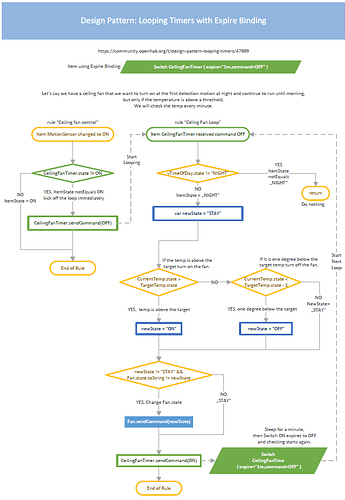

To understand how the rules “Looping Timers with Expire Binding” works, I’ve created a program flowchart. (Hopefully without mistakes)
Maybe it will help others too.
Design Pattern - Looping Timers with Expire Binding.pdf (222.9 KB)
