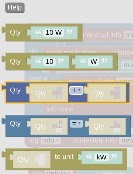

I have an issue with these yellow and blue blocks both named “Qty”.
I do understand the difference but I wonder if it’s clear enough so that everyone does understand the difference (I don’t believe so).
I don’t disagree but I also have no power over that. I’m not sure what it should be labeled though.
When adding them to the script it’s pretty obvious what they do though.
But once they are added to a script it does become a little jumbled.
