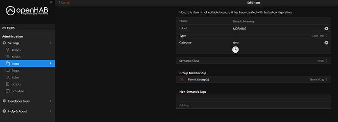

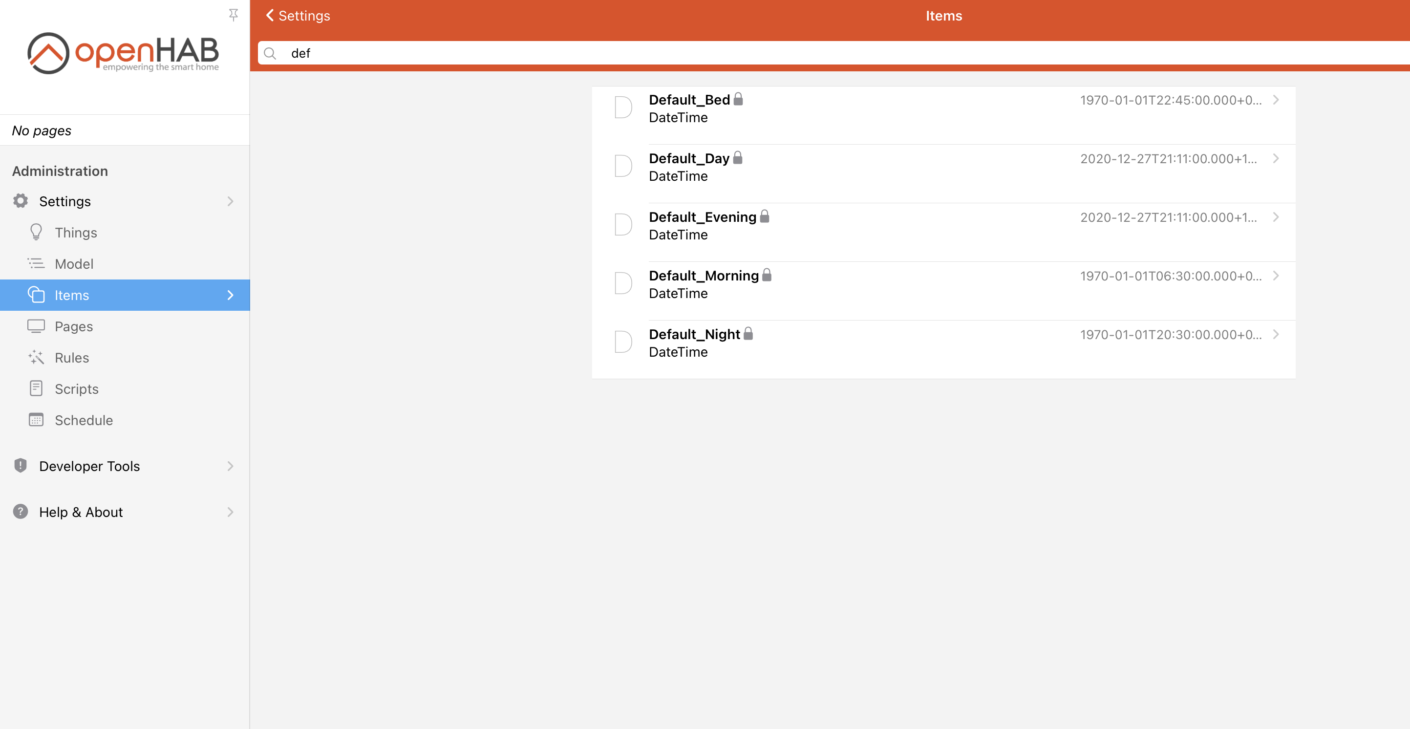

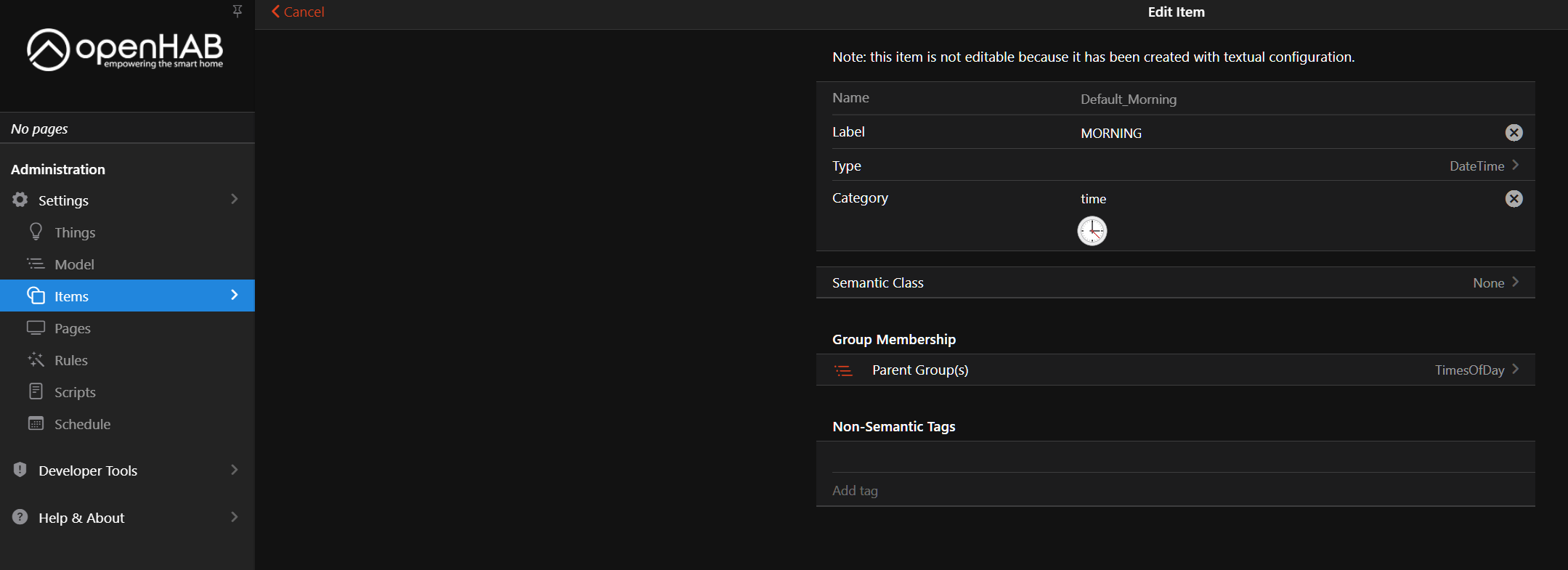

How did you do this?
I only get:
And this ERROR when I run the rule:
2020-12-28 00:01:00.850 [ERROR] [internal.handler.ScriptActionHandler] - Script execution of rule with UID 'b6c5df081b' failed: Default_Morning's state is undefined
Invalid metadata for Item! Expected metadata in the form of etod="STATE"[type="daytype", set="dayset", file="uri"] where set is required if type is dayset and file is required if type is custom. in <eval> at line number 255 at column number 6

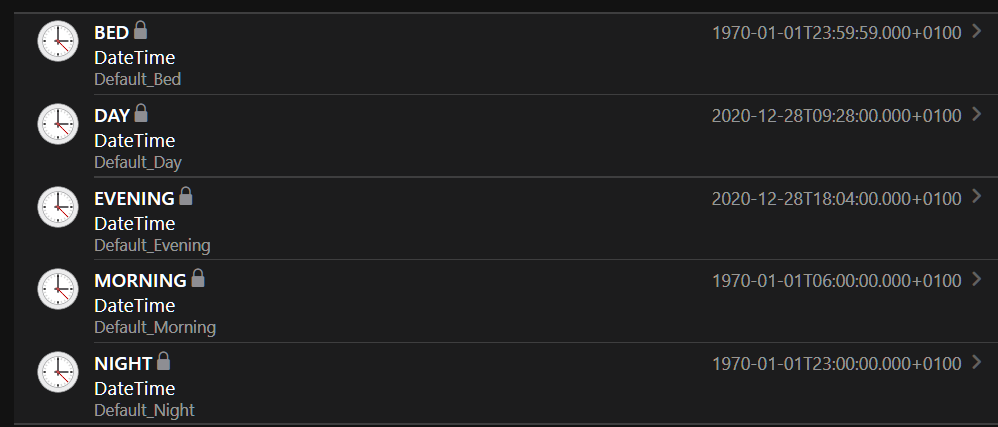

As I said before, use the console. If you look at it in karaf, you’ll probably notice that its state is NULL:
items list | grep Default_Morning
So you just have to initially give it a value:
openhab:send Default_Morning hh:mm:ss
After that it should look like this:
Default_Morning (Type=DateTimeItem, State=2020-12-27T05:15:00.000-0600, Label=MORNING, Category=time, Groups=[TimesOfDay])
Probably with a date in 1970, but that will be updated if you manually run the script.
