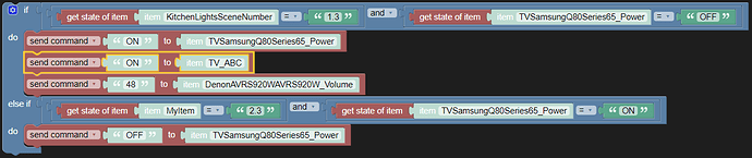

Here is an example of a double press scene rule for my kitchen dimmer. Triggered on scene change (1.0 is single press, 1.3 is double press). Turns on the TV (if OFF), turn on proxy switch that turns the channel to ABC, and sets receiver volume to 48.
