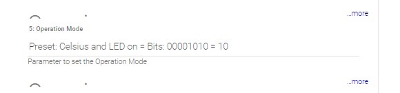

In the Things preset there is default (1010) at option “5”, which should be correct.
But when checking in oH console it shows me “60” (Fahrenheit) instead “16” (Celcius).

devolo-preset

Wondering, if I enter in parameter no. 5 the “10” to use Celsius, in the logfile I see and in the PaperUI Thing-configuration the field is empty again:
2019-01-27 17:20:45.060 [vent.ConfigStatusInfoEvent] - ConfigStatusInfo [configStatusMessages=[ConfigStatusMessage [parameterName=config_2_1, type=PENDING, messageKey=null, arguments=null, message=null, statusCode=null], ConfigStatusMessage [parameterName=config_8_1, type=PENDING, messageKey=null, arguments=null, message=null, statusCode=null], ConfigStatusMessage [parameterName=config_4_1, type=PENDING, messageKey=null, arguments=null, message=null, statusCode=null], ConfigStatusMessage [parameterName=group_2, type=PENDING, messageKey=null, arguments=null, message=null, statusCode=null]]]
Other parameters I can change and the are store, without a log entry.
But in the parameter 5 I can enter whatever, the error appear and the value is not stored (after opening again the field is empty, see screenshot)
Is the device broken?para-no5
