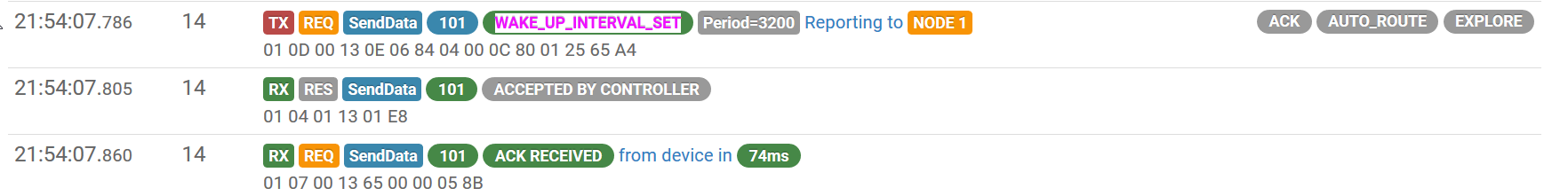

So I might have finally been able to change the Wakeup Interval and so get much better results in my battery draining problem. I got these log entries, when changing the intervall and after that waking up my device.
Interval set to 1 (well, it set this itself after I changed more than one parameter at once. Maybe the trick is, to only change one parameter at a time and first make sure, it got accepted):
I will keep an eye on this, if everything still works properly tomorrow. But I hope my problem will be solved!

Are the numbers unter the log entries hex-values and can one tell what they mean? I found the Period-Setting in the fifth and sixth number group from the left and some seem to always be the same.
