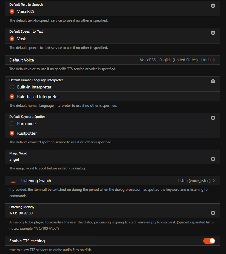

OpenHab:
model file in folder:
m:\servers\openhab\userdata\rustpotter\angel.rpw
trying to start rule
startDialog("rustpotterks", "voskstt", "voicerss", "voicerss:enUS_Linda", "system,rulehli", "javasound", "enhancedjavasound", "en-US", "angel", "voice_listing")
But in logs error
2023-11-21 13:12:10.895 [WARN ] [.core.voice.internal.DialogProcessor] - Encountered error calling spot: Unable to load wake word model: Semantic(None, "missing field 'name'")
Help me please!

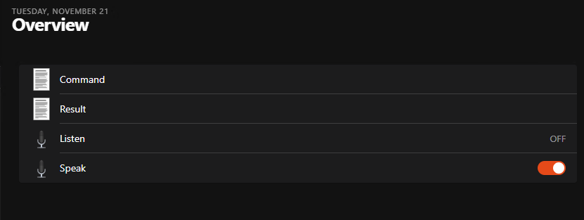

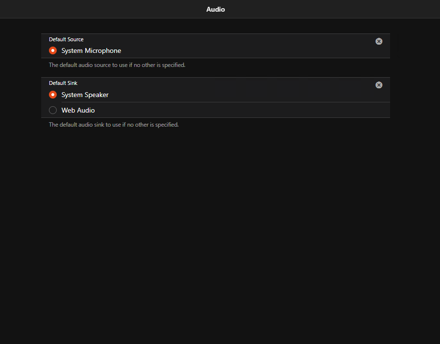

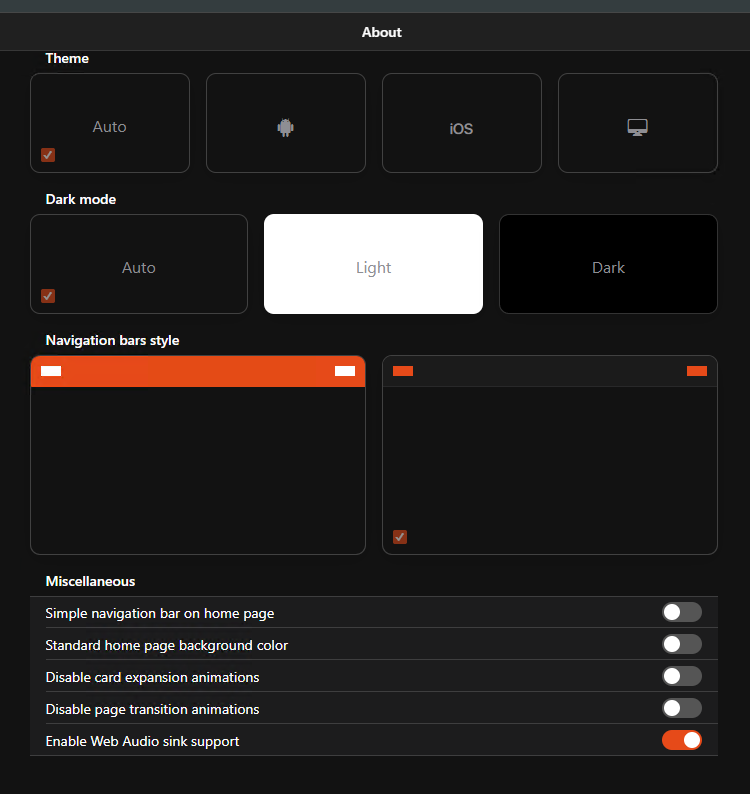

Please tell me, I understand (I hope) that I can enable constant listening to the microphone on the server and respond to voice commands from the microphone connected to the server. I don’t know how yet (I haven’t finished it), but I’m sure I can.
But how can I do the same for a browser on a computer? It seems to me that this is not possible for a browser. I don’t see a microphone in the site settings! Can output sound, but there is no microphone.

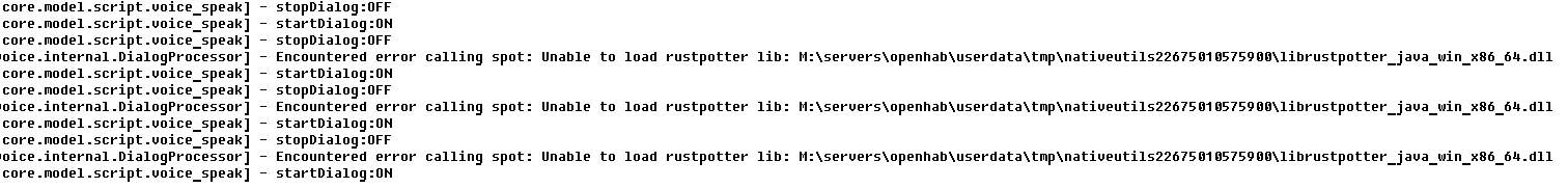

Error in logs when enabling/disabling ‘speak’ switch using trigger in rules
rule "Voice Speak"
    Item voice_speak received command
  if(ON === voice_speak.state) {
    logInfo("voice_speak", "startDialog:" + voice_speak.state.toString)
  else {
    stopDialog("javasound")
    logInfo("voice_speak", "stopDialog:" + voice_speak.state.toString)
There is a file on the disk
M:\servers\openhab\userdata\tmp\nativeutils22675010575900\librustpotter_java_win_x86_64.dll
The first time with switch = on everything is fine, but the second and subsequent times it writes an error. Perhaps the library is already loaded?
Sorry, I was outside, it was too much to answer from the phone.
Yes, you are right, I fixed that on the v3 version :confused: It only causes errors on windows which is a platform I rarely use so I didn’t discovered it until I was testing the v3. I didn’t realize it was affecting the OpenHAB add-on. I think adding a bolean to avoid registering the library multiple times should do the trick, it is what the library does now. I can open a PR agains the 4.0.x add-ons branch, with that fix, or if you want to do it, for me it will be better to avoid to setup a windows installation right now to test it, let me know.

Adding voice features to OpenHAB is my Saturday morning project since a while ago haha. I started having zero knowledge about audio, but I love using voice control and open source software, so I got into it. Also, in general this project is a masterpiece, and the reviews tend to be really meaningful, so far it has been a great experience and I have learned a lot.
By design OpenHAB can control the audio sources, so when you start a dialog, under the hood OpenHAB is starting the constant audio streaming from the source implementation to the keyword spotter implementation.
There is no source implementation in the UI at the moment.
I have a project in the marketplace called HABSpeaker which includes a Sink and Source implementation over Websocket, with automatic dialog setup, if you can give it a try a give me feedback that would be awesome. I had some problems at that project and let it quite buggy for a time due to several causes so I think that people that have tested it until now didn’t have a great experience with it :frowning: , but I think the audio implementation is a good work, and the sink is real time and support concurrent streaming, which is an advantage over the current one, so I hope one day it can be ported or integrated into the MainUI, but right now I’m giving priority to finish some addons and to some changes I want to make on the interpreter, because I’m already using it on a daily basis. If you have an Android, I suggest you to use the android apk, it didn’t require https (which is a browser security measure to capture the microphone) and is the one I use more at the moment, because I only have one speaker, when I want to send a command from another room I use the phone.

Last night, while testing the operation of startDialog when called from the rules or the OH console (openhab:vocie startdialog), I discovered that after executing stopDialog (openhab:vocie stopdialog), I get a dll loading error in the logs, and then subsequent calls to startDialog (or openhab:voice registerdailog->openhab:voice unregisterdialog->openhab:voice registerdailog) will be fail until the server is restarted.
Fix the unload error? I’m a programmer, I won’t sleep if I don’t fix it)))))
Now I won’t be able to test the wake word.
Both systems don’t work (on windows 10/server 2022 maybe)
  1. Rustpotter - crash on second use, a server reboot is required
  2. Porcupine - error checking the api key, and therefore doesn’t work. I don’t know what to do with this. A test application separate from OpenHab works without problems with this api key.

I just opened these PR with the fix, but I’m having problems with the format checks.
https://github.com/openhab/openhab-addons/pull/15945
You can build the add-on with mvn spotless:apply clean install -pl :org.openhab.voice.rustpotterks in case you want. Or you can upgrade to OpenHAB 4.1.0M3, for me it’s working nice.
The reason you can avoid passing some parameters is because both method fallback to the defaults configured in the voice settings. The registerDialog method call the startDialog under the hood, so you should not get different results, the only difference is that the registerDialog stores your preferences and call the startDialog in case the dialog is stopped (system reboot, temporal unavailability of the sink/source…), If you register a dialog and you stopped it using the stopDialog it will be started again after some seconds.
Probably it needs an update on the library. The thing is that I’m not going to use that project anymore so I’ll ask for the removal these weekend or for someone to take it, because I don’t want to be dealing with the api key, the account… for now rustpotter is working quite good for me, so I have zero motivation on invest time on it. But maybe another people is interested on keeping it.

The rule-based interpreter should work, if you are using the defaults when creating the dialog, you must restart the dialog in order for it to use the new selected interpreter, you can verify the interpreter in use using the voice dialogs command, you should check the “HLIs” section.
openhab> voice dialogs
 Source: pulseaudio:source:df54bf45b3:Jabra_Speak2_40_Echo_Cancel_Source - Sink: pulseaudio:sink:df54bf45b3:Jabra_Speak2_40_Echo_Cancel_Sink (STT: whisperstt, TTS: pipertts, HLIs: system, KS: rustpotterks, Keyword: ok casa, Dialog Group: default) Location: BedRoom
The standard interpreter is not yet documented, I’ll try to open a PR for the documentation these weekend. I can try to help you if you translate the commands to English because I have not clue of German sorry :frowning: but as a summary the standard interpreter have some build-it grammar which is loaded depending on your server language and tries to match the commands to the items using its label and/or its parent labels.
For example if you have a group labeled as “bedroom” which contains an item labeled as “light”, you can use the command “turn off the bedroom” | “turn off the bedroom light” | “turn off the light” as far as there are not more that one item compatible with the OFF commands that matches those labels.
Hope it helps, I’ll try to upload the documentation soon.
Thank you, the problem was that the dialog wasn’t updated despite restarting. after removing it manually and restarting the correct dialog was created.
