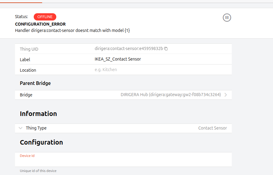

on the UI i see
Status: OFFLINE
CONFIGURATION_ERROR
Handler dirigera:contact-sensor doesnt match with model {1}
Seems to be a wrong log error, the attr for the log message is not filled (see {1})

Digigera hub is online
goto Things β†’press (+) select digigera binding
  1. press 4 times couple Button on Parasoll door contact and scan in Bindinding does not work
  2. select in digigera Binding doorcontact and fill out the form works and i got this error
    i have the thing connected with the digigera hub shown above
FUN Fact: this morning the doorcontact shows Green (Online), after chaangeing the label of the thing i got again config error shown in the image above
Digigera Hub has Firmware Version 2.934.0
Version of Matter Controller is 1.0

Funfact again: it was short online and after changeing the Label, i got the same Error as showhn before.
Now it works after connecting the doorcontact via IKEA-App with th hub
(SOLVED)
