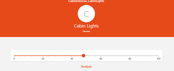

The item in OH works fine when then slider is moved and % bar moves correcltly. However, when the OFF buttom on the switch, this does not reflect in the OH item, it just stays at the last % value, as below;
How can I get this to show the light it OFF in OH?
