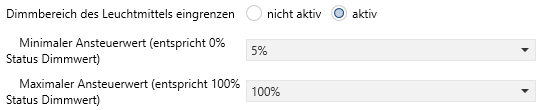

This is my limit setting in ETS:
I tried to recalculate the range in excel with this formular, but no luck so far: return ((value - 5) / 95) * 100;
