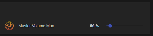

I setup a simple dimmer like this in my items file - no rules or complexity attached:
Dimmer NoiseProtection “Master Volume Max [%d %%]” (GRule)
I added the item into my sitemap:
Default item=NoiseProtection
Whenever I change the dimmer, it’s getting only updated on Basic UI after I press “F5” for refresh. In the iOS mobile app it works like a charm.
Example:
Change the dimmer to low, it still shows 56%.
After refresh, it shows the correct value --> 15%.
Any clue?

Events.log (not reflecting 100% the example values above).
2019-12-31 10:42:17.198 [ome.event.ItemCommandEvent] - Item ‘NoiseProtection’ received command 26
2019-12-31 10:42:17.205 [vent.ItemStateChangedEvent] - NoiseProtection changed from 68 to 26
