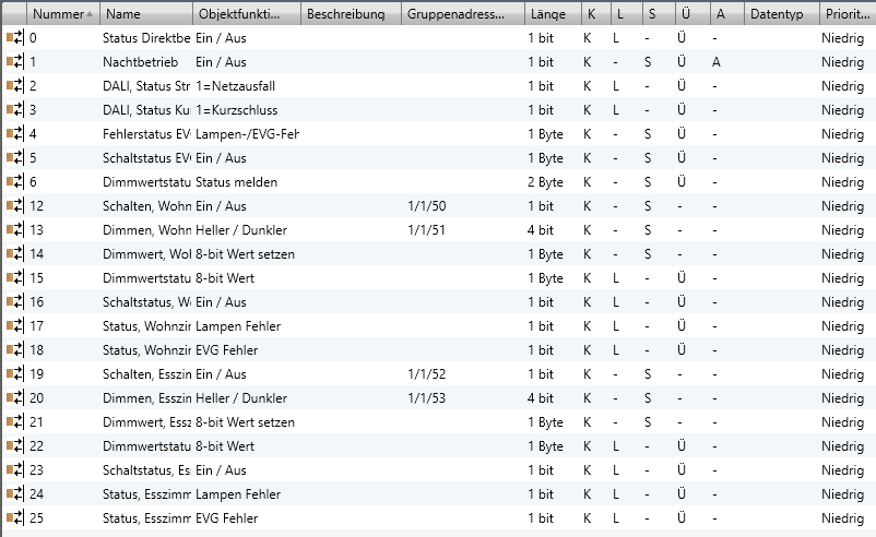

I need help in inplement a slider in sitemap for DALI light in KNX enviroment. Because i have
one ga for switching and one ga for dimming. I use the Siemens Dali Gateway N 141
My config is:
knx.items
Dimmer Wohneff_Schalter_W2 “WEffekt Licht” (gEG, Wohnzimmer, Lights) [“Erdgeschoß”] { channel=“knx:device:RASPI-EIB:TSM10B412_13:Channel_101” }
knx.things
Thing device TSM10B412_13 "Wohnzimmer Schalter" @ "Wohnzimmer" [ address="1.1.37", fetch=false, pingInterval=600, readInterval=0 ]
Type switch : Channel_100 "Wohnen Licht" [ ga="1/1/50" ]
Type dimmer : Channel_101 "Wohnen Dimmen" [ switch="1/1/50", position="", increaseDecrease="3.007:1/1/51" ]
maybe some hint how to solve this Prob?
