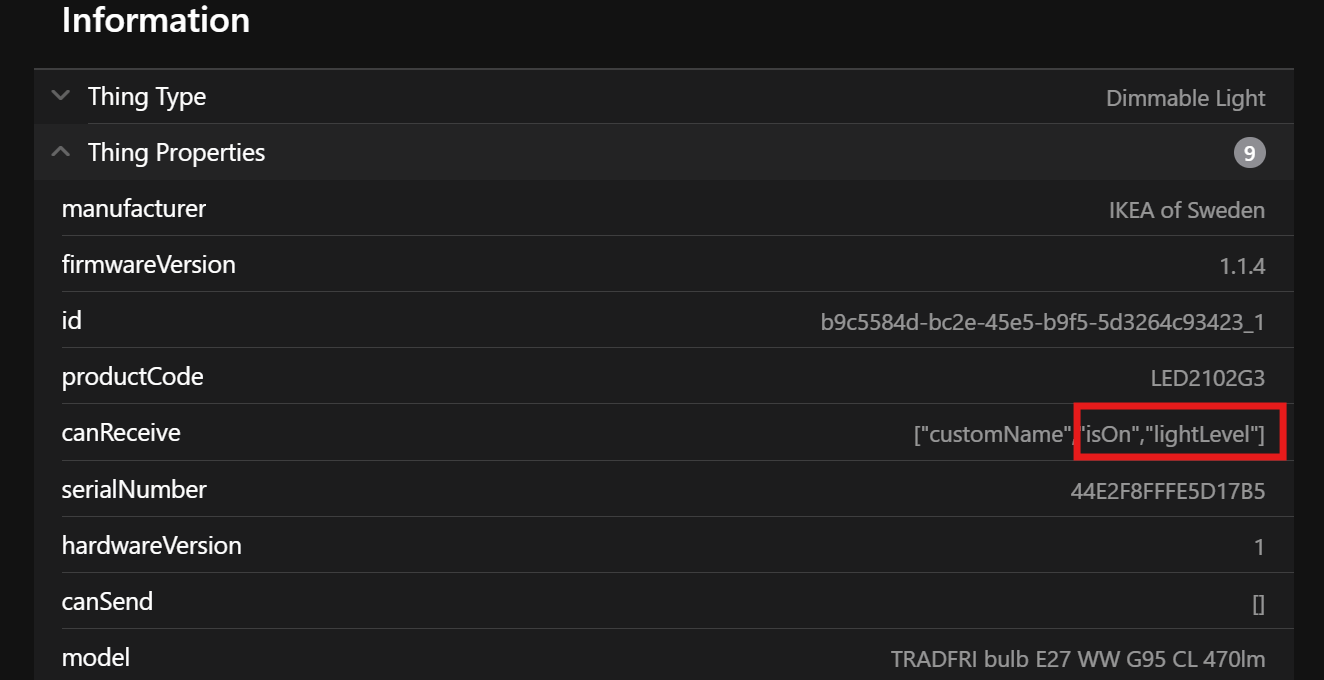

In raw json from DIRIGERA hub all bulbs, LED strips and panels are simply typelight. Binding decides which ThingType to use based on the canReceive capabilities. Below you can see the bulb canReceive isOn and lightLevel so Thing Type is Dimmabale Light.
  • Do you have IKEA Home smart running? - Yes, I can control the bulbs from the app
  • Are there new device discoveries from DIRIGERA in your thing Inbox? - No, I removed them but they are not discovered and not in the Inbox
Then let’s cross check the properties.
  1. What’s the Thing Type and Thing Properties of your handler? (Screenshot from my previous post)
  2. What’s the data of DIRIGERA hub?

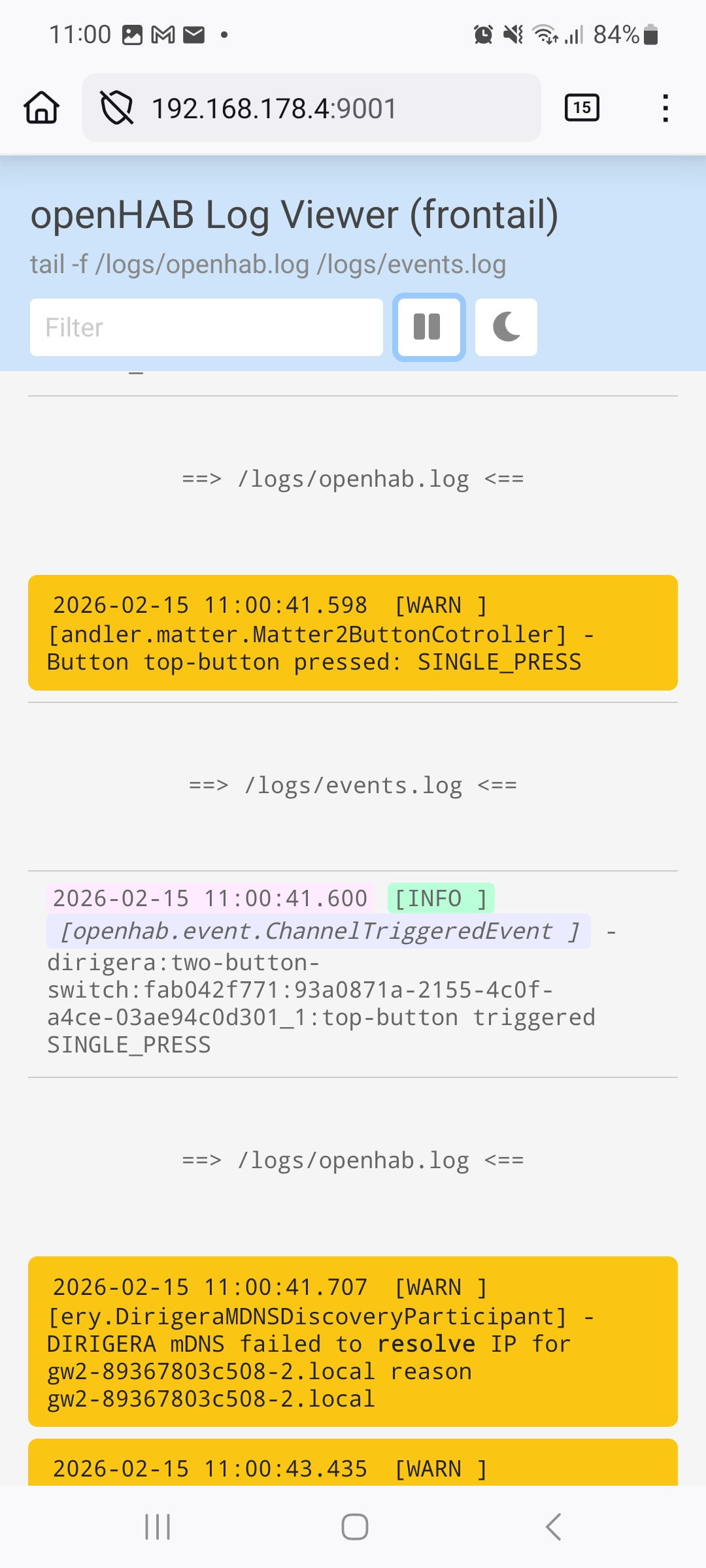

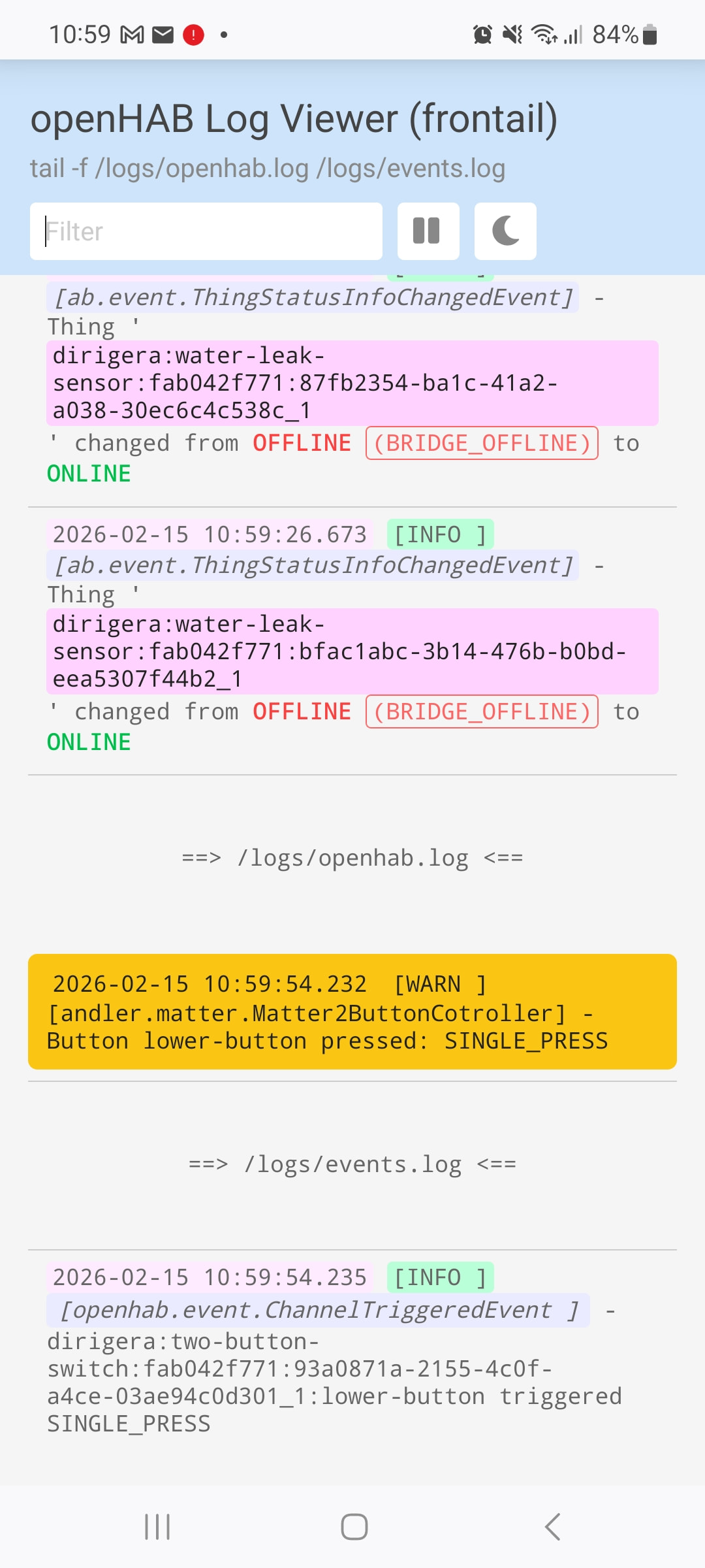

Bilresa dual button seems to work, here some logs. I am not able to use these in rules. But the problem there seems to be me.
You’ve a rule example for DSL in readme.
I switched to javascript rules and use BILRESA to switch ON/OFF our Towel Warmer in the Bathroom.
Copy your trigger channel uid from the thing and put it in and the rule shall be fired!
