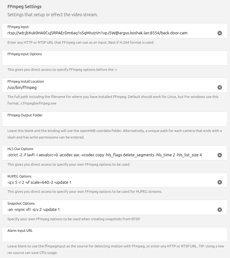

If you navigate to the Thing’s page and toggle “show advanced” near the top right you’ll see a field where you can set the ffmpeg command line arguments for snapshots.
Rick, you are my mentor! I know those fields very well. There are fields several controlling the ffmpeg output, both from MJPEG and for Snapshot, but the one that I need to override is “FFmpeg Input Options”. This one sets the parameters for ffmpeg BEFORE the -i rtsp:… parameter.
ffmpegInputOptions
Allows you to specify any options before the -i on the commands for FFmpeg. If you have an ESP32 camera that only has a mjpeg stream then make this equal -f mjpeg.
