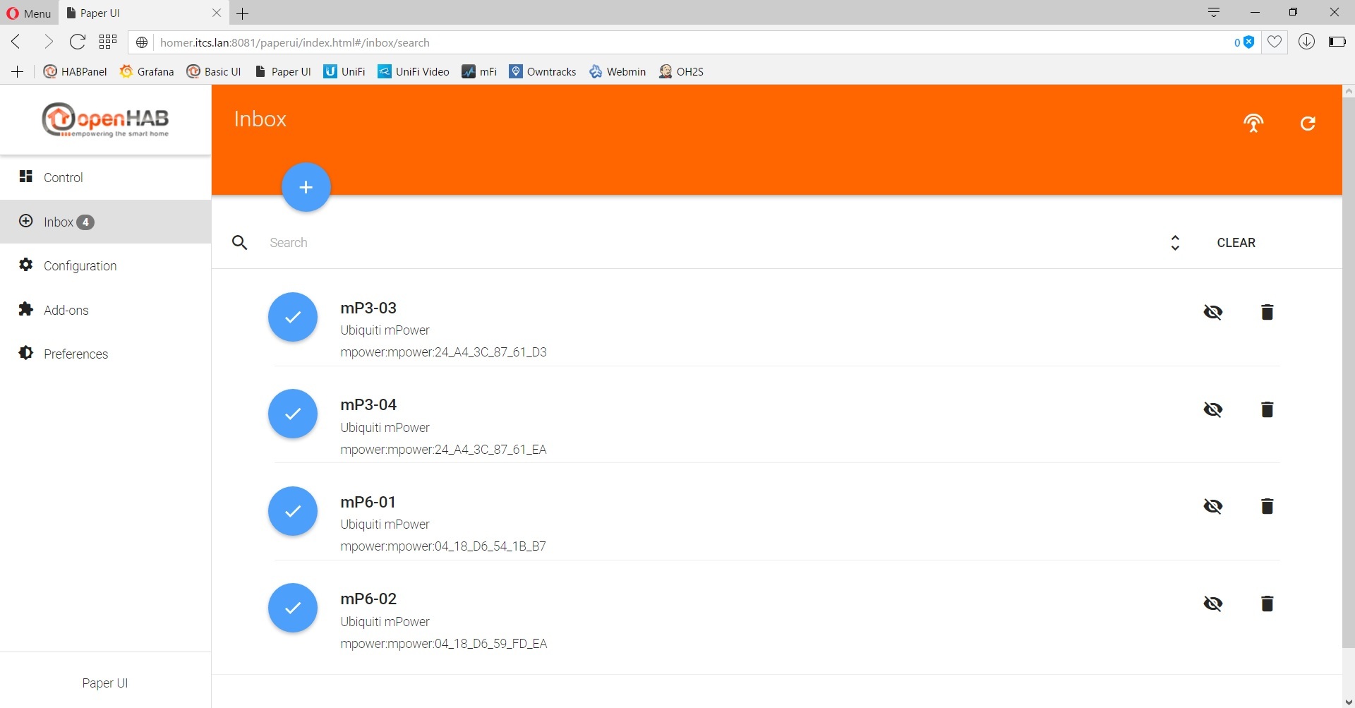

2017-01-20 22:56:45.950 [DEBUG] [rnal.discovery.MpowerBridgeDiscovery] - Manufacturer matched: search: Ubiquiti Networks, device value: Ubiquiti Networks.
2017-01-20 22:56:45.952 [InboxAddedEvent           ] - Discovery Result with UID 'mpower:mpower:24_A4_3C_87_61_EA' has been added.
2017-01-20 22:56:45.955 [InboxAddedEvent           ] - Discovery Result with UID 'mpower:mpower:04_18_D6_54_1B_B7' has been added.
2017-01-20 22:56:45.956 [InboxAddedEvent           ] - Discovery Result with UID 'mpower:mpower:24_A4_3C_87_61_D3' has been added.
2017-01-20 22:56:45.957 [InboxAddedEvent           ] - Discovery Result with UID 'mpower:mpower:04_18_D6_59_FD_EA' has been added.
Testing more stuff now… So far, it’s fast, it’s good and it works ! :slight_smile:

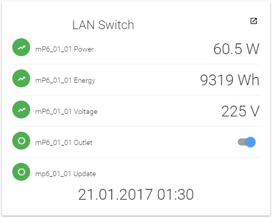

and associated mPower.items file, linking the items to the channels:
Switch		mP6_01_01_O	"mP6_01_01 Outlet"		(gmPower)	{channel="mpower:socket:04_18_D6_54_1B_B7:1:outlet"}
Number		mP6_01_01_P	"mP6_01_01 Power [%.1f W]"	<energy>	(gmPower)	{channel="mpower:socket:04_18_D6_54_1B_B7:1:power"
Number		mP6_01_01_E	"mP6_01_01 Energy [%d Wh]"	<energy>	(gmPower)	{channel="mpower:socket:04_18_D6_54_1B_B7:1:energy
Number		mP6_01_01_V	"mP6_01_01 Voltage [%d V]"	<energy>	(gmPower)	{channel="mpower:socket:04_18_D6_54_1B_B7:1:volta
ge"}
DateTime	mP6_01_01_U	"mp6_01_01 Update [%1$td.%1$tm.%1$tY %1$tH:%1$tM]"	<text>	(gmPower)	{channel="mpower:socket:04_18_D6_5
4_1B_B7:1:lastupdate"}

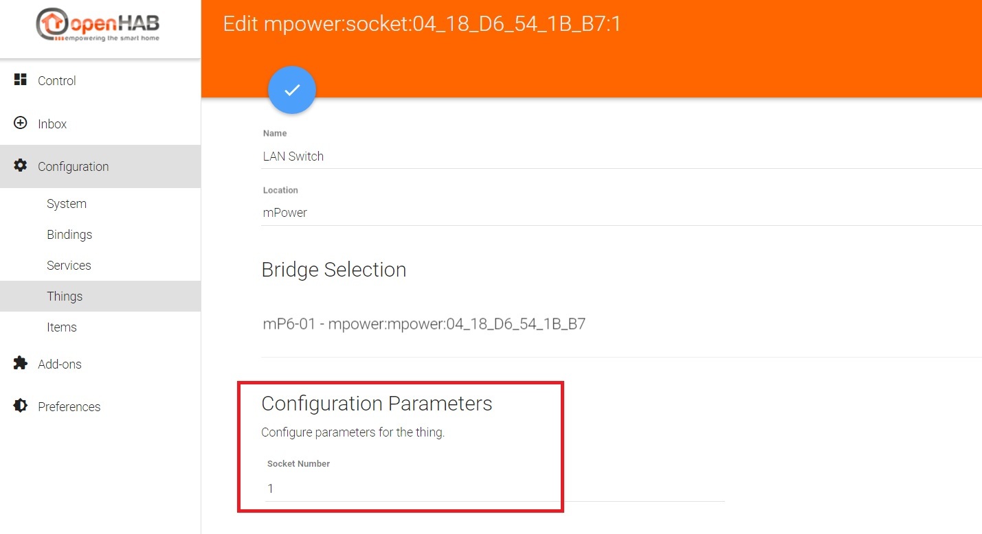

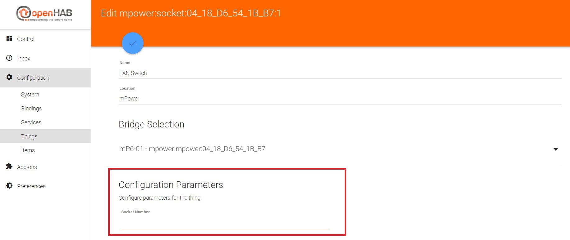

Only 1 small/minor issue to report from my test environment:
If I define manually the bridge (power strip) and the sockets in a file (/etc/openhab2/things/mPower.things) :
Bridge	mpower:mpower:04_18_D6_54_1B_B7	"mP6-01"	[ host="172.16.13.1", password="ubnt", username="ubnt" ]
	socket	1	"LAN Switch"	@	"mPower"	[ socketNumber="1" ]
	socket	2	"HomeR"			@	"mPower"	[ socketNumber="2" ]
	socket	3	"NAStorage"		@	"mPower"	[ socketNumber="3" ]
	socket	4	"ZTE Router"	@	"mPower"	[ socketNumber="4" ]
	socket	5	"HP Printer"	@	"mPower"	[ socketNumber="5" ]
	socket	6	"rPi3"			@	"mPower"	[ socketNumber="6" ]

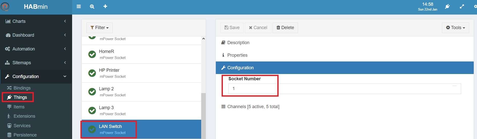

…the socket number is not displayed when I navigate to the thing from Paper UI (Paper UI → Configuration → Things → Edit)
…on HABmin, it displays correctly:
If I define my things via Paper UI, all works ok (if I remember well.. i will double check). This is not important, since if you are working with manual definitions, you won’t be able to modify the thing config parameters from the UIs anyway, so it’s ok.
please try:
remove all your things from *.things file.
Save *.things file
revert everything and remove the quotes around socketNumber value
Save *.things file
Works?
socket	1	"LAN Switch"	[ socketNumber=1 ]
Hell, yeah :slight_smile:

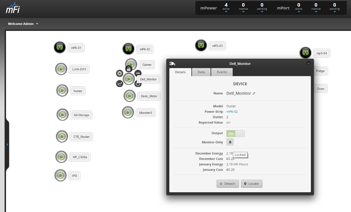

I also like that if I lock one of the outlets in the mfi controller suite (put it in monitoring mode only), I cannot switch it off from OH2 :slight_smile: (this works as I expected)
Thanks @Dim for all your testing efforts :bow:
Oh! I didn’t know about that feature. So its rather coincidence that the binding works “as expected”.
But … would it be an idea to add this feature to the binding? Like
socket  1       "LAN Switch"    @       "mPower"        [ socketNumber=1, monitoringMode=true ]
(No idea yet, how exactly this featured is realized on mPower “OS Level” though.)
That would be a nice extra feature (to be able to lock / unlock the outlet from openHAB2 also)
In the mfi controller, you can set this lock when you configure the device:
This disables the On/Off button and the outlet cannot be switched off (either from mfi or from openHAB)
