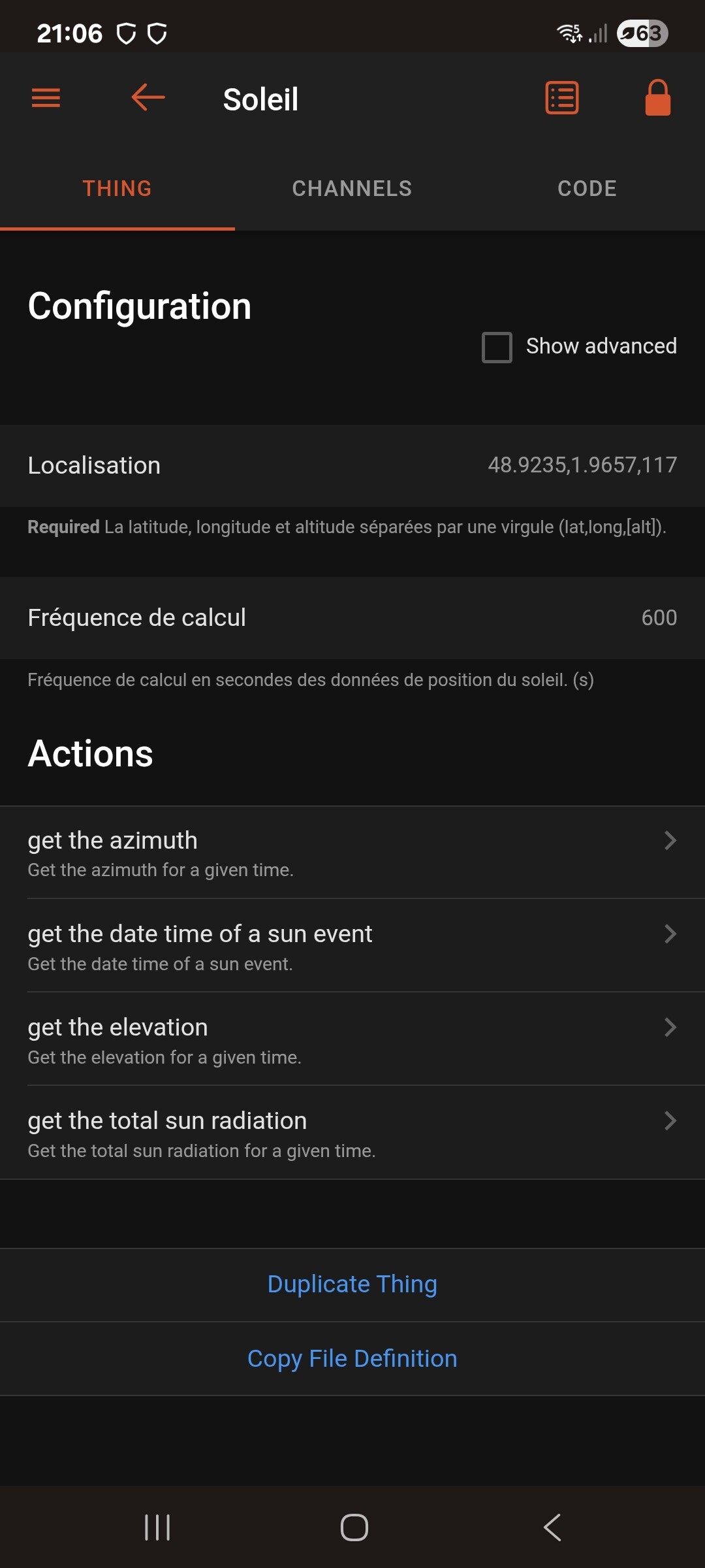

This already exists from the Thing property page

I tested this in openHAB 5.1.4 with a small binding-side ThingActions implementation, exposed through getServices() and annotated with @RuleAction / @ActionInput.
Result: the actions do indeed appear directly on the Thing properties page, with an input dialog generated from the action method parameters. So this is exactly the native path I was looking for.
I also checked ActionInputsHelper and now understand that action inputs are mapped to ConfigDescriptionParameter instances, which explains the rendered input fields. For richer persistent UI controls like options/sliders, channels or config descriptions still seem to be the better fit, but for one-shot operations like reboot(), permitJoin(), stopJoin(), rediscover(), forget(), Thing Actions are a clean solution.
