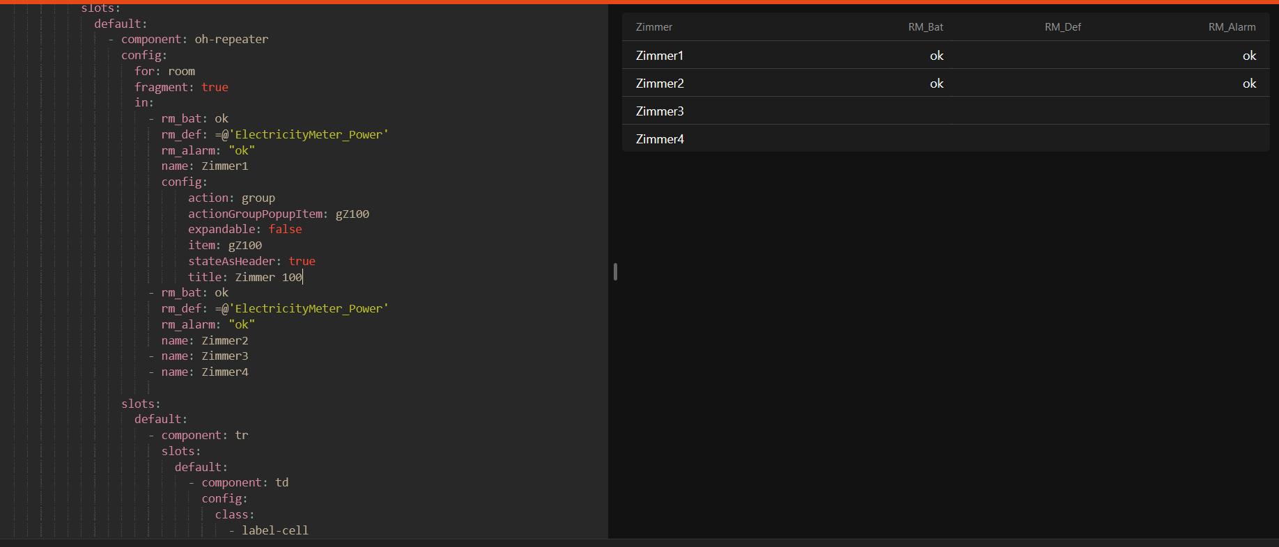

Hi, I would like open the GroupItem in an table entry on main ui widget.
I have a example atteched, but it doesnt display the content of the groupItem.
Additional the fix item name in a table cell doesnt work - example: rm_bat: =items.testitem.state
What is wrong on the example?

uid: overview_table
tags:
props:
parameters:
parameterGroups:
timestamp: Dec 2, 2023, 3:03:54 PM
component: div
class:
- card
- data-table
- data-table-collapsible
- data-table-init
default:
- component: table
config: {}
default:
- component: oh-repeater
config: {}
- component: thead
default:
- component: tr
default:
- component: th
class:
- label-cell
content: Zimmer
- component: th
class:
- label-cell
content: RM_Bat
- component: th
class:
- label-cell
content: RM_Def
- component: th
class:
- label-cell
content: RM_Alarm
- component: tbody
default:
for: room
fragment: true
in:
- rm_bat: ok
rm_def:
lable: =items.Sensor_CPUTemp.state
rm_alarm: ok
action: group
actionGroupPopupItem: gZ100
expandable: false
item: gZ100
stateAsHeader: true
title: Zimmer 100
- rm_bat: ok
rm_def: =@‘ElectricityMeter_Power’
rm_alarm: ok
- name: Zimmer3
- name: Zimmer4
default:
- component: tr
default:
- component: td
class:
- label-cell
content: =loop.room.name
data-collapsible-title: Zimmer
- component: td
class:
- numeric-cell
content: =loop.room.rm_bat
data-collapsible-title: RM_Battery
- component: td
class:
- numeric-cell
data-collapsible-title: RM_Def
default:
- component: span
visible: =loop.room.rm_def < 10
content: =loop.room.rm_def
- component: f7-chip
visible: =loop.room.rm_def >= 10
color: red
text: =loop.room.rm_def
icon-f7: exclamationmark_triangle_fill
style:
font-size: var(–f7-table-body-font-size)
- component: td
class:
- numeric-cell
content: =loop.room.rm_alarm
data-collapsible-title: RM_Alarm
Let me see if I understand what you are trying to do. You want the config configuration in the loop array
  action: group
  expandable: false
  item: gZ100
  stateAsHeader: true
  title: Zimmer 100
to apply to the configuration of the one of the components in the table. Is that correct?
If that is correct then you cannot do this directly. The each of the key within in the config object are evaluated as expressions, but the config object itself is not, so you cannot assign some other object variable to a components config.
Your only hope would be to list each of the config keys and match them up one-to-one with the keys from the loop array like this:
  action: =loop.config && loop.config.action
  actionGroupPopupItem: =loop.config && loop.config.actionGroupPopupItem
