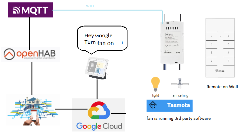

How my system works is very complicated and I have different solutions and different ways to control things as a backup.
Example My aircons/HVAC
The sensibo to google took about an hour to setup and just works. I have had very little issues with it.
Now that we have a sensibo binding it is very easy to setup automations in openHAB like.
When the temp outside reaches a SETPOINT and it is THIS TIME OF THE DAY then DO THIS
Another Example is my IFAN03 for celling fan and lights

The setup picture was just an example - currently I do not have anything installed.
