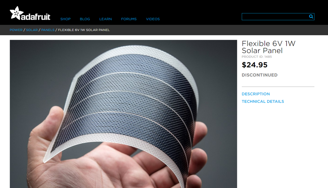

I’m new to all of this, so if is not even close to doable then forgive me N00Bness. My next project is blinds just like what you are doing. but I might just run wires through my attic, as it’s not too difficult.
building on CeeCee idea, maybe a flexible solar panel that opens when the shade opens, in a way that is not noticeable (have a few ideas).
or wait for the solar panel window films and add a couple of those (lol)
then connect that to a charger and lipoly or life battery.
here are some ideas. just put some random stuff together, to give you more ideas man. i love brainstorming, and helping out.
please keep us informed on what you decide. might help us out. THANKS!

Personally, I would not be opposed to having a solar panel on each window, but I admittedly don’t know much about designing that. I do believe you would require some type of charge controller to prevent the batteries from overcharging. Not to mention it would add cost per blind.

Depending on how deep you are into electronics, this might be a tough thing to crack. Unless you have a lot more sun than where I am, there’s no way you will be able to keep the radio on (rx) the whole time. (unless you want to put a rather large solar panel in your window, with battery backup or super cap for night time operation/cloudy days.)
