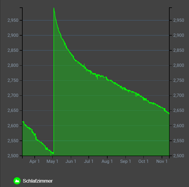

ESP8266 using the REST Interface to post the data @ wakepup every 30 minutes = ~1 year battery life
@halloween
simple ESP.deepSleep(1800000000); //30 minutes
Dont forget to tie the RST pin to GPIO 16 (ESP-12)

What kind of batteries do you use? 2 x AA ?
Can you provide your complete esp-code? I´m a noob in esp or arduino programming :frowning:
Do i have a benefit, if i use mqtt? I think, with rest interface i will get the same data into openhab with less work? I only want to get temp/humidity and maybe with another sensor board co2 and VOC.
@halloween
no problem, im using 2x AA batteries:
