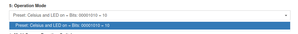

I have a problem with a Dlink door/window sensor and I don’t know how to work around it. The sensor is a DCH-Z110. It seems to me like the configuration parameter 5 (Operation Mode) is preset to 10 (Celsius and LED indicator ON). I cannot find a way to change the parameter, and I really would like to as I do not want the LED indication turned On.
I have tried to change it in both HabMin and Paper UI with no luck. I guess I need to change some configuration file somewhere or maybe even use the REST API.
It was inadvertently set so you could not change it due to a database issue. I just updated it so it should be available in a binding snapshot in about a week.
Ideally that parameter should be broken up by bitmask but I am not confident doing that on the new site.
