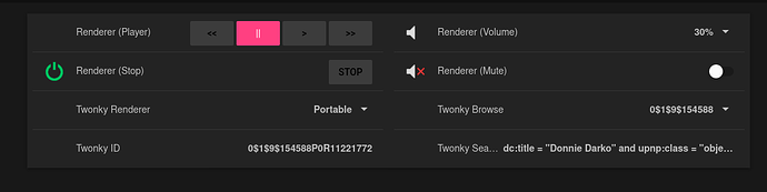

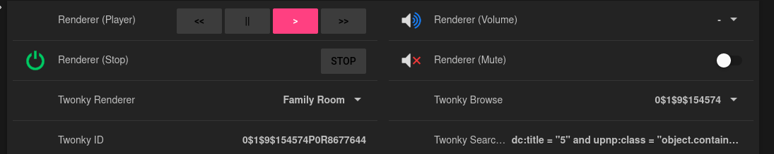

In testing the latest from your fork in Basic UI, Mute seems to behave differently than the previous version, but the Item still does not reflect the current state of the speaker. I know they are different, but Stop is also not updating correctly. Both can still be controlled by toggling the switch though, so both still seem to be functional.
Media Server
Having to refresh is unfortunate, because this is such awesome functionality! The only issue I have come across is that sometimes the command to navigate up the tree does not do anything. I’ve gotten it unstuck by navigating down and then up again. I’ve only seen this in the UI, but I suspect it is happening in my rule below too, since sometimes nothing plays. This is what was causing me trouble earlier.

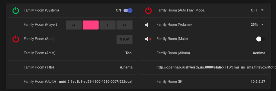

The added Channels for the UPnPServer are great! They work properly, but Player and Stop are not updating in the UI. This was while music was not playing and after a refresh…
UPnPServer channels.log (6.7 KB)
… but the Items for the renderer were displayed correctly. Possibly related… when the Renderer is changed, I would expect that the Items would get updated, but this does not appear to be happening.

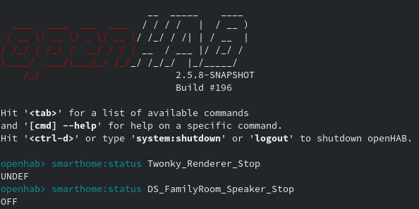

STOP
I understand Stop better now. The renderers already had states assigned for Stop and the binding is not updating the states.
Is the intention to configure the Stop Items with autoupdate=“false”? The trouble with this is that the Alexa skill does not work with Items that have this setting. At least, it didn’t at some point and I am not aware of it changing.

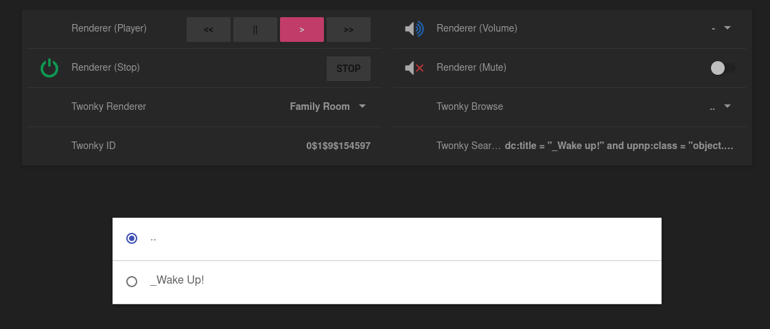

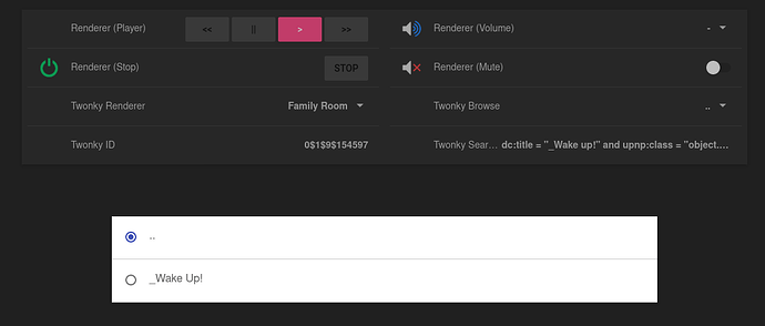

BROWSE

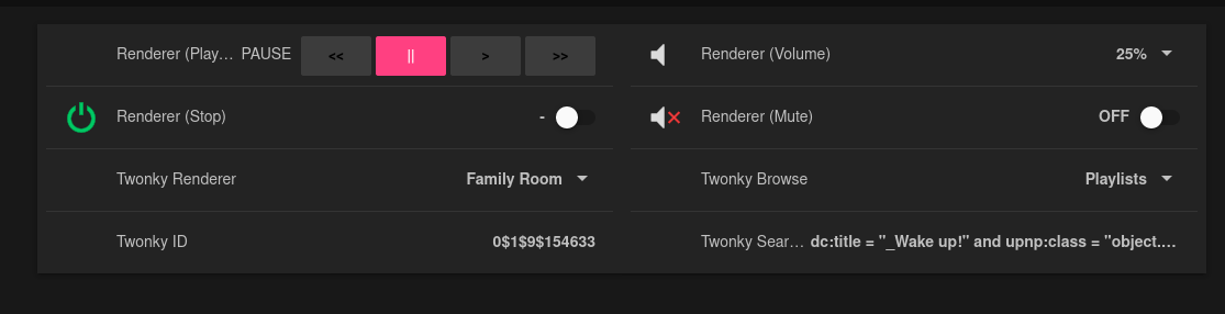

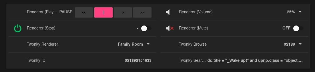

After a selection is made, the title of the current selection appears. After refreshing, the ID appears, which is different than what is displayed by currentid. Is Browse supposed to display the title of the ID?
Before refresh…
After refresh…

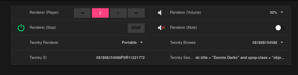

SEARCH
Running this…
from time import sleep
from core.log import logging, LOG_PREFIX#, log_traceback
LOG = logging.getLogger("{}.TEST_3".format(LOG_PREFIX))
LOG.warn("START: Twonky_Search_Criteria: {}, Twonky_Browse: {}, Twonky_ID: {}".format(items["Twonky_Search_Criteria"], items["Twonky_Browse"], items["Twonky_ID"]))
# selected playlist
events.sendCommand("Twonky_Browse", "..")
sleep(0.25)
# selection of playlists
sleep(0.25)
# Artist Index, Artist/Album, By Folder, Genre/Artist/Album, Playlists
sleep(0.25)
# Music, Photos, Videos
LOG.warn("BEFORE: Twonky_Search_Criteria: {}, Twonky_Browse: {}, Twonky_ID: {}".format(items["Twonky_Search_Criteria"], items["Twonky_Browse"], items["Twonky_ID"]))
if items["Twonky_Search_Criteria"].toString() == 'dc:title = "5" and upnp:class = "object.container.playlistContainer"':
    events.sendCommand("Twonky_Search_Criteria", 'dc:title = "_Wake up!" and upnp:class = "object.container.playlistContainer"')
else:
    events.sendCommand("Twonky_Search_Criteria", 'dc:title = "5" and upnp:class = "object.container.playlistContainer"')
sleep(0.25)
LOG.warn("AFTER SEARCH: Twonky_Search_Criteria: {}, Twonky_Browse: {}, Twonky_ID: {}".format(items["Twonky_Search_Criteria"], items["Twonky_Browse"], items["Twonky_ID"]))
… the binding logs this…
Search.log (23.8 KB)
… and the script logs this…
2020-08-19 18:22:02.613 [WARN ] [jython.TEST_3] - START: Twonky_Search_Criteria: dc:title = "5" and upnp:class = "object.container.playlistContainer", Twonky_Browse: .., Twonky_ID: 0$1$9$154574
2020-08-19 18:22:02.865 [WARN ] [jython.TEST_3] - BEFORE: Twonky_Search_Criteria: dc:title = "5" and upnp:class = "object.container.playlistContainer", Twonky_Browse: .., Twonky_ID: 0$1
2020-08-19 18:22:03.116 [WARN ] [jython.TEST_3] - AFTER SEARCH: Twonky_Search_Criteria: dc:title = "_Wake up!" and upnp:class = "object.container.playlistContainer", Twonky_Browse: .., Twonky_ID: 0$1$9$154597

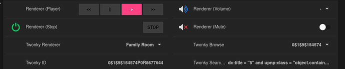

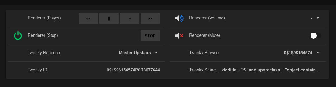

The Browse Item is not updated, but the CurrentID is. I need to manually update the Browse Item with the CurrentID Item in order to play the search result. If I run this and go to Basic UI, the BrowseStateDescription is populated…
… and I can make a selection to populate Browse and then hit Play. What I’d like, is to Search and have Browse populated, so that I can just hit Play. Or maybe Play could start on it’s own after a successful search. If implemented, all you’d need is to set the state of Search to play a playlist.

After playing with it some more, sending 0 to currentid is not working. Actually, I had browsing hang up on me a couple times after using it…
stopped browsing.log (32.7 KB)
That’s a problem. The channel definition for stop includes autoupdate=veto, which means it will always have autoupdate=false for the item. That’s what makes most logical sense in a UI, as stop does not have a state, but is a command. Alternatively, I need to build in a lot of logic to maintain a proper state for it. I don’t use Alexa. Is this still a problem? If Alexa just sends commands to an item, it wouldn’t know about this autoupdate policy flag. What makes it different?
Looking at the log, there is a check if the URI has been set before starting to play. The timeout is 2.5s on that. The URI is set after the message it was missing according to the log (but the message was less than 2.5s before setting). I added a log statement to see the exact cause.

The state should revert to Play 2.5s after setting pause if no PAUSE_PLAYBACK or STOP is received.
Not sure about this one. I haven’t seen it in PaperUI. This is a command option, so refresh should not do anything to the list. I made a change, so check how it behaves.
I believe I have fixed this.
True, but I opted for consistency with the browse channel. When browsing, you may be going up and down the tree, and only start playing when you are at the right level. Otherwise, players would continuously receive new queues. I understand that could be shortcut with search, but I think it is worth keeping things consistent.
Search is not exactly where I want it to be yet. I need some more time refining.
Info was starting to get lost here, so I opened an issue to track it better…
You got my speakers to pause! The states seem better, but I am getting a lot of timeouts (see GH issue), so hard to test. Should pressing pause twice pause then unpause, or do you need to press Play to unpause?
No change for Basic UI…
Paper UI displays the options.
Yes, this is working now… thank you!
Looks good, except for the Player, which looks to be UNDEF after changing the renderer.
I would need a log here. It is supposed to refresh the status, and will only put it to UNDEF if it does not receive anything. I have multiple servers, but only on renderer in my test setup, so difficult to test with this setup at the moment.
I believe you should press play to unpause. In PaperUI, the control only shows one button for play/pause that changes image depending on the state.
I am wondering if this has something to do with this: PR #217. Support for command options seems to be early days.
Browse has no state, so it actually should not show anything, except the possibility to select from a list. When selecting, it will browse on that entry. The options list in browse is what is supposed to be played. The CurrentId contains the parent of the first entry in the list.
I did discover a bug with search (error in filtering duplicate entries resulting in an empty list). This should make search work better, but probably not perfect yet.
If you search on a container, the result in browse will be a container. You will still have to go down in the browse on that container to get the content in the option list to be able to play. If you search on individual objects, you should see these directly in the browse option list, and that is also what will play.
