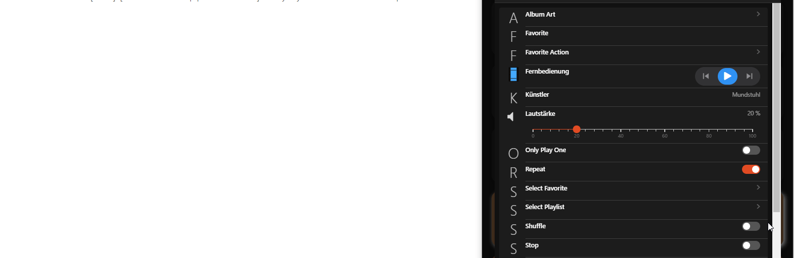

But in general the dynamic update of the renderer and browser channels works:
Renderer:
Browser (current media id):
Starting with the widget from ysc I made the upper one for my upnpserver and the lower one for all of my speakers:

Just saw that setting shuffle to true also sets onlyplayone to true but doesnt update the channel/item:

Are you sure your items are linked to the right channel?
I just asked myself the same and checked it:
Its just that particular single item thats linked to that channel.
I made a new gif which shows filters for shuffle and onlyplayone:
ctQ24FXEXp
I think I can workaround this issue for now. I just verified that it affects at least one other players (mopidy+upmpd) of mine. =(

I found the issue in the code and submitted [upnpcontrol] fix shuffle switch also switching only play one by mherwege · Pull Request #14490 · openhab/openhab-addons · GitHub to fix this. It is on the 4.0 branch, so will not be available immediately on 3.4. If you are eager to get it, I would need to compile a 3.4 version.
