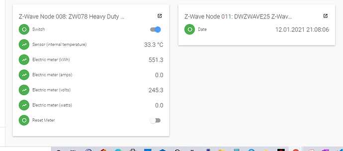

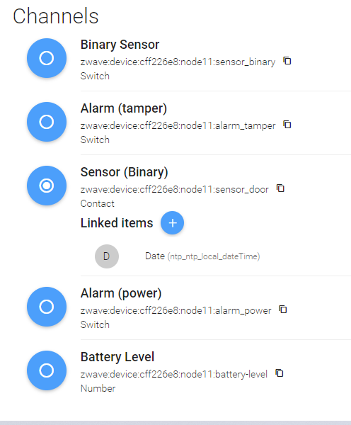

I have had limited success in including my Ecolink door / window open indicator model DWZWAVE2.5-ECO, and my Aeotec Doorbell 6 ZW162 that was not supported in the item list.
To make the channels appear in the âControlâ window, I needed to add an item to the channels declared in the things window. I stared with no entries in the control window for the ecolink to a time stamp displayed for change of state. I did this:
