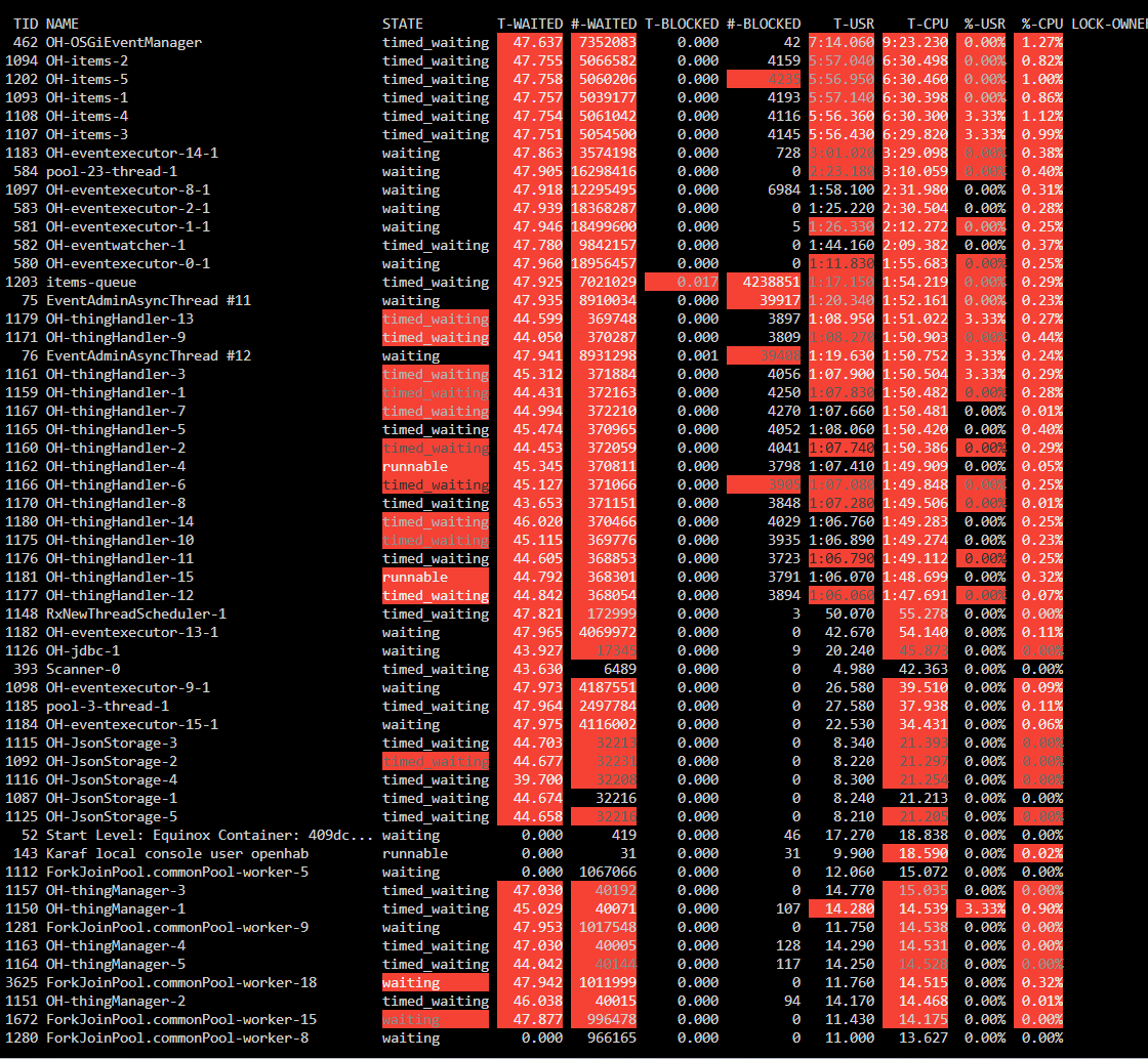

just for fun, I did the ttop command as per the link you provided. Here’s the current output

I assume there is nothing in the right two columns. That is where we will see threads being locked. I don’t see anything remarkable in this screen shot at the moment. It will be potentially informative when things start to go wrong.
I never really dug down into to what ttop shows to be sure that I get all that I can get from it. But, my goal is thread deadlocks or “serious thread slowdowns”, as the most “usual” cause for thread exhaustion, and to see those, I need a thread dump where the locks/monitors/mutexes are shown. Because, they are what reveals what thread is waiting for what, and that can let me track down where the “knot” that starts the whole pileup is. The Karaf thread-dump, unfortunately, doesn’t include this information, and I’ve found no way to make it do so. During a “normal” thread dump, this is the -l (for Locks I assume) argument, but it’s not implemented in the Karaf dump.
This is why I documented other ways to make thread dumps, because with a Karaf dump, I can see “that there is an issue”, but I can’t trace its origins.
