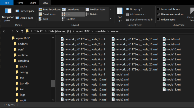

In the userdata zwave folder there should be an xml file generated for that node. Posting it would be helpful.

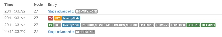

There’s very little in the log file for node 27. It doesn’t look like the device is waking up at all. Perhaps check the procedure you’re using to wake it up?

@Bruce_Osborne Interestingly, there is no XML file for this node (Node 27) in the folder. See screenshot.

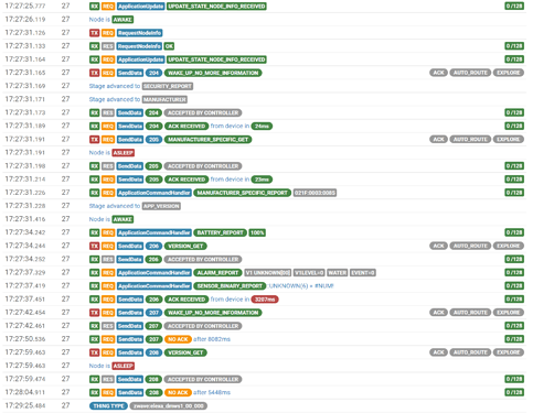

If there is no xml file it has not been fully discovered by the binding. This is quite common with battery powered devices. When adding as a Thing the device needs to be kept awake until the initial discovery is complete. I believe if you use HABmin you can see the discovery progress by looking at the Thing status.
On mine, the 2 second press-and-hold doesn’t wake up the device. However, on my device, triple-clicking will cause the device to send a NIF, which the binding treats as a wakeup. You can verify by tailing the log file.
If this works for you, and you’re able to get the device fully discovered, double check the wake up interval. Mine was set to a very large number (several days). I had to set it back to 3600 seconds.

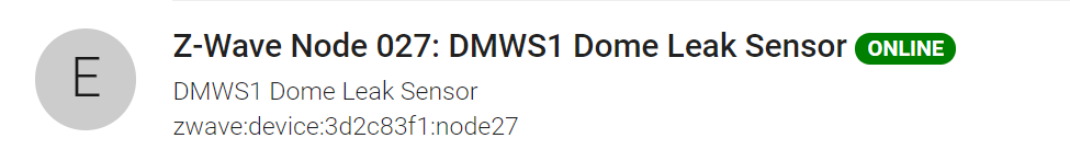

Mark, thank you so much! You suggestion completely solved the device discovery issue!
To those of you who may be considering this sensor and using the Aeotec’s Z-Stick Gen5 controller, this is what you have to do:
  1. Unplug the Z-Stick controller and put it into inclusion mode.
  2. Triple click the button on the device. The Z-Stick LED should turn solid blue for a few seconds to indicate the device has been recognized.
  3. Plug the controller back into the USB port and restart openHAB.
  4. Once openHAB is fully online, again triple click the button on the device. This will allow the binding to discover device. Note that the normal wake up method (press-and-hold the button for 2 seconds) does NOT enable the binding to discover the device at all.
  5. You should now be able to add this device as a thing.
