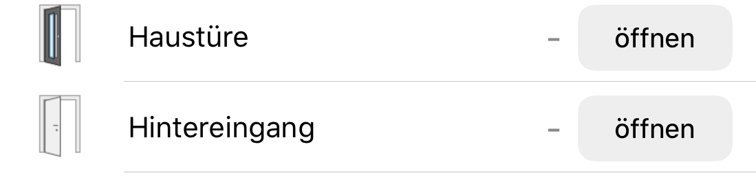

I have a question regarding the openDoor1 and openDoor2 channels: I use them with autoupdate=“false” and added them to the sitemap with a switch, which is using a mapping. The result is a single button in the sitemap. I use this method for many other channels. But in the left of the doorbird channels the switch’s state is shown. Is it possible to hide the state?
Thank you!
Olliver

mhilbush:
sure
Sure:
Items:
Switch SPA01_Door1 "Haustüre" <frontdoor> {channel="doorbird:d210x:spa01:openDoor1",autoupdate="false"}
Switch SPA01_Door2 "Hintereingang" <door> {channel="doorbird:d210x:spa01:openDoor2",autoupdate="false"}
Sitemap:
Switch item=SPA01_Door1 mappings=[ON="öffnen"]
Switch item=SPA01_Door2 mappings=[ON="öffnen"]
Result:
The state of the two items is null, because autoupdate is set to false.
Regards,
Oliver
mhilbush
(Mark)
October 6, 2019, 4:45pm
154
Can you try changing the item definitions to this (note the empty brackets)?
Switch SPA01_Door1 "Haustüre []" <frontdoor> {channel="doorbird:d210x:spa01:openDoor1",autoupdate="false"}
Switch SPA01_Door2 "Hintereingang []" <door> {channel="doorbird:d210x:spa01:openDoor2",autoupdate="false"}

mhilbush:
Thank you, worked for me. But why is it necessary only for doorbird channels?

It’s not specific to Doorbird channels. I use this in a variety of places unrelated to Doorbird when I use a mapping and don’t want the state to show up.
Edit: It’s been discussed here on the forum a couple times. Here’s an example.
if have a switch (with custom dynamic item which works):
Switch Keymatic_State "Haustür" <keymatic> {channel="homematic:HM-Sec-Key:ccu2:XXXXXXXXXX:1#STATE"}
and a mapping in the sitemap:
Switch item=Keymatic_State label="Haustür" mappings=[ON="Offen",OFF="Verschlossen"]
My Problem: the stateformat is shown in basicui (and also in the app):
[image]
What can i do?
Greetings,
Skibi
