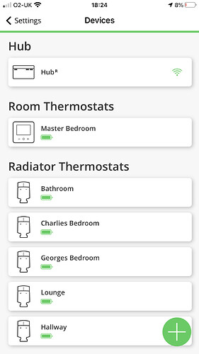

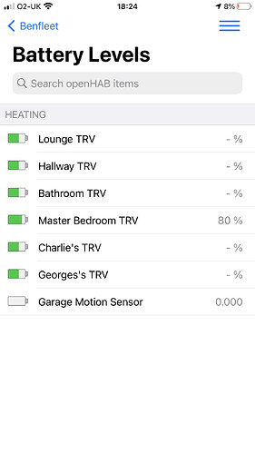

Did something Drayton end just change on the battery level side?
Literally half hour ago all my battery levels went UNDEF - all other channels working and when I opened app got asked if I’d like to enable notifications for battery levels which seems a coincidence
Haven’t checked logs yet as not by a pc.
Strange.. one just came back..
Wonder if there’s something being done their end.
Possibly, I had an email today saying they’re updating the TRV firmware so they operate quieter and batteries last longer.
The fact one is still working makes me think it’s a comms issue. Have they reappeared yet?
They’re constantly dropping off / reappearing (just battery levels), normally once or twice per day. I haven’t had a chance to check logs atm as so busy at work. Not sure if it’s a wiser issue or a 3.x issue as started after I upgraded from 2.5.x but also when I got the first email from wiser regarding changes which included battery levels.
