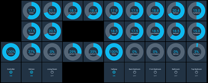

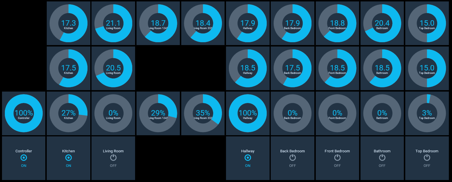

…and a quick screenshot of data pulled into HABPanel. No hot water data yet of course…

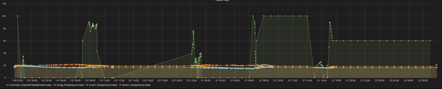

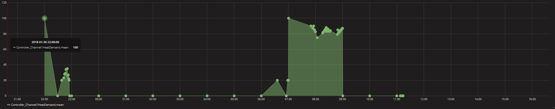

I am trying to get some graphs that will show me how often my boiler kicks in and at what %, so far I managed to get something like this:
The main issue I have is that the controller stops “reporting” to our binding?

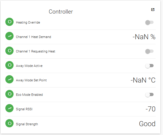

Why it is being reported as a NaN, is there any way to fix this?

It’s less than ideal at the moment, but when you first load PaperUI it will show NaNs for a number of items. If you leave PaperUI open it should never get into this state unless something goes wrong.
I’m hoping to spend a bit more time working on the binding this evening which might include a fix for this.
Are you sure the boiler is definitely “on” when the graph is showing “off”.
Out of interest, what persistence and charting are you using for those graphs.

I am sure the boiler is ON, but in the graph is showing as OFF because of the “NaN”, and I am also checking PaperUI (even if I keep it open for longer periods of time at some point it changes to “NAN” without any apparent reason).

A few assumptions I’ve made about your setup:
  • You’re requesting influxdb updates “every change” rather than “every update”
  • You’re using fill(previous) in grafana so that if the value doesn’t change, it isn’t plotted as null

Yes, it is quiet close to my setup I would say, and yes I am updating “every change” instead of “every update”, do you think I should do different?
