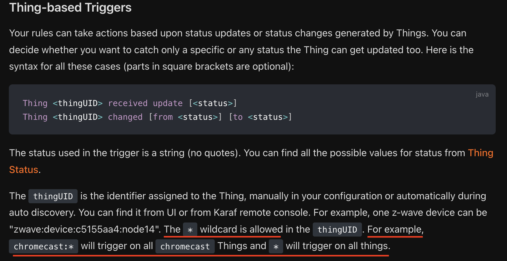

You cannot trigger upon wildcards. Not sure if (double or single) quotes are allowed here.

Yes you can.

Interesting, never heard about before. Is that documented anywhere? If no, could you please add it? And is it the all-wildcard “*” only or truely a pattern?
@s0170071 your "homatic:*" would also not match, it’s "homematic:*"
