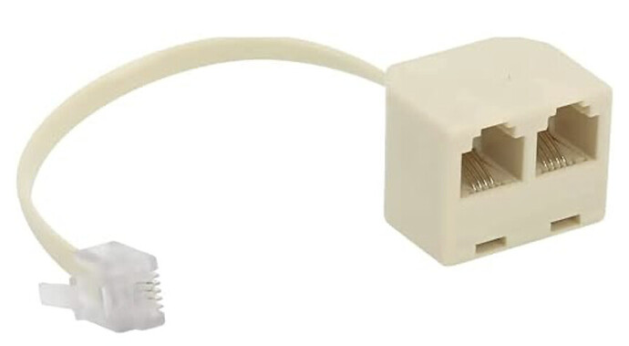

Anyone has tried to connect two cables on the P1 port ?
What did you use as a “splitter” ?

I bought a 6P4C RJ11 Male to Double RJ11 (7EUR) on a famous American website that sells from a to z and it works perfectly.
Thx for the info!
