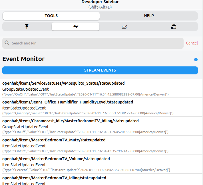

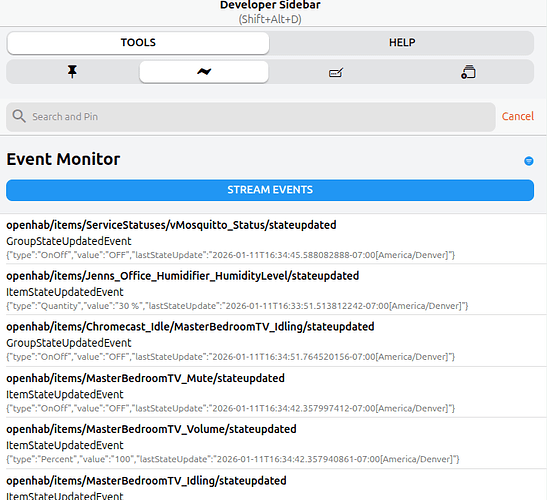

So I opened up the Event Monitor and added “openhab/items/*/stateupdated” to the Filter Topic dialog and it made no difference in the display. Nothing I’ve ever put there seems to do anything. Does it work? Is there some magic incantation I need to do? Here’s what that looks like in case I did it wrong.

I put openhab/items/*/stateupdated into the filter and started streaming and it worked as expected.
