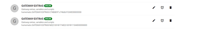

i found and have duplicate homatic things and bridges:
Have anyone seen this before? The diffrent is the Bridge Name. But which is the correct?
thanks Joris
thanks Joris
They are both online
Look at both config and channels
And check to which of these your items are connected to
Delete the other one
I had problems after updating to the latest openhab Version 2.4. And can’t see what’s the right Binding…
I deleted one of them and check the ccu (yahm).
I can’t see the correct name / serial in the ccu..![]()
I have the same problem. Both thinks are working correct. It doesn’t matter which one I use.
