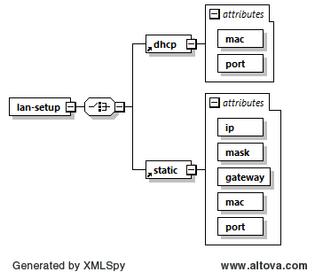

<lan-setup mode="DHCP" mac="dc:a6:32:4f:cf:cc" port="10000" />
<lan-setup mode="STATIC" IP="192.189.1.1" mask="255.255.255.0" gateway="192.168.1.250" mac="dc:a6:32:4f:cf:cc" port="10000" />
The first might be the most backwards compatible The last would obviously require a custom widget. And I don’t know if any of those would work at all. The thing is, I can make it work for me. But if I contribute a binding, what should I be giving others? No one will see or care what I implement here, but what I release into the wild matters.

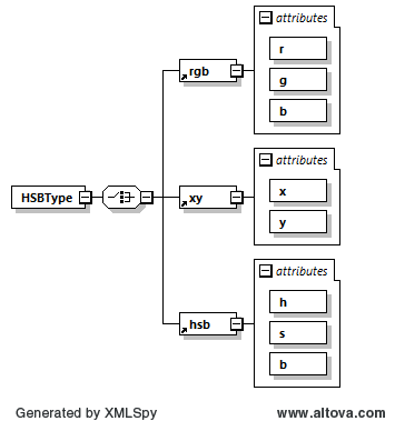

Yes, that is a theoretical example of a single channel which encapsulates multiple, context specific values. The theoretical xsd would look like this:
now, isn’t that the same abstraction as HSBType? The theoretical xsd would look like this:
Even in it’s simplest implementation HSBType is a 3 value tuple which would represent 3 different commands and 3 different statuses on the physical device. It’s been aggregated into a single channel where the tuple allows the values to be used together in the appropriate context, while eliminating the complexity of inter-channel dependencies.
It would seem that the platform has already had to cope with complexity beyond one primitive type per channel, and the pattern of one context per channel seems to have already been implemented.

What does lan setup do? Is it to configure how to connect to the device or something else?
I’m really most interested in the abstraction. I gave a concrete example just for understanding. Most LAN connected devices today include their network setup in their API. Network setup is a poor use case from a ā€œdemandā€ perspective since I doubt that ranks high as something people want access to, but network setup is a readily understood use case because it’s so ubiquitous.
The abstraction I’m trying to get across is an aggregation pattern. A collection of values which can, and probably should, be treated as a single unit. If the channels get too granular then you run into problems interpreting them if the change of the value in one channel changes the meaning of other channels.
It makes sense to carry HSB as a tuple in a single channel. The are other cases where one context per channel would make more sense than multiple primitive vales spread across multiple channels.

I think a String type will carry an XML fragment, so as long as I can construct a UI element which implements the XSD the framework wouldn’t need to know or care, but I’m not sure about that. I do know that it tries to parse strings into more specific types if it can get a match.
