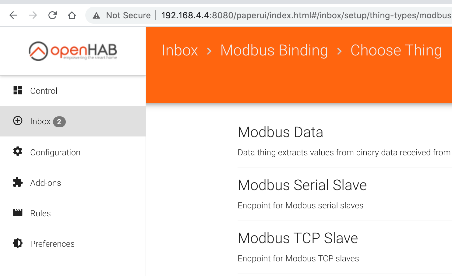

I understand that [modbus] Fixes #8538 (modbus extensions missing) by pail23 · Pull Request #8575 · openhab/openhab-addons · GitHub does the same for the main branch now, so there the problem should be fixed.
Iâm really not sure if thereâs a way to offer the extensions other then providing download links to the JARsâŠ
Did that, without any visible change. Afterwards iâve added modbus-e3dc to /etc/openhab2/services/addons.cfg, but this didnât worked well:
2020-09-28 09:34:03.813 [ERROR] [core.karaf.internal.FeatureInstaller] - Failed installing 'openhab-binding-modbus-e3dc'
Any suggestions?
I donât think addons.cfg needs to be adapted. I just dropped my bundle in the addons folder - thatâs it! So after copying the bundle into addons folder youâre still not able to see E3DC devices in PaperUI via Modbus Binding?
Correct, iâve just dropped the jar bundle and even restarted openHAB without success.

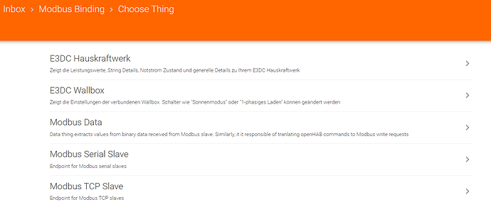

Thank you, that filesize stuff was the right hint. Iâve re-downloaded the file and now everything seems working.

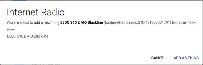

I encoutered the same problem with my E3DC system, but with some strange behavior:
My E3DC is appearing in the Thing inbox as a FSInternetradio thing.
Any idea?
Bernd
is this Thing automatically added into your Inbox? Seems that the Internet Radio Binding discovers the E3DC device as radio station. Thatâs weird!
The E3DC Binding doesnât provide automatic discovery service. You have to setup it manually.
Hi Bernd,
yes, it is discovered automatically.
Including all the undocumented features: Power on/off, Volume, Current titleâŠjust kidding
Anyway, I tried manual setup, still struggling with this..
Bernd
Please tell me where youâre struggeling. Maybe I can improve the setup description!
