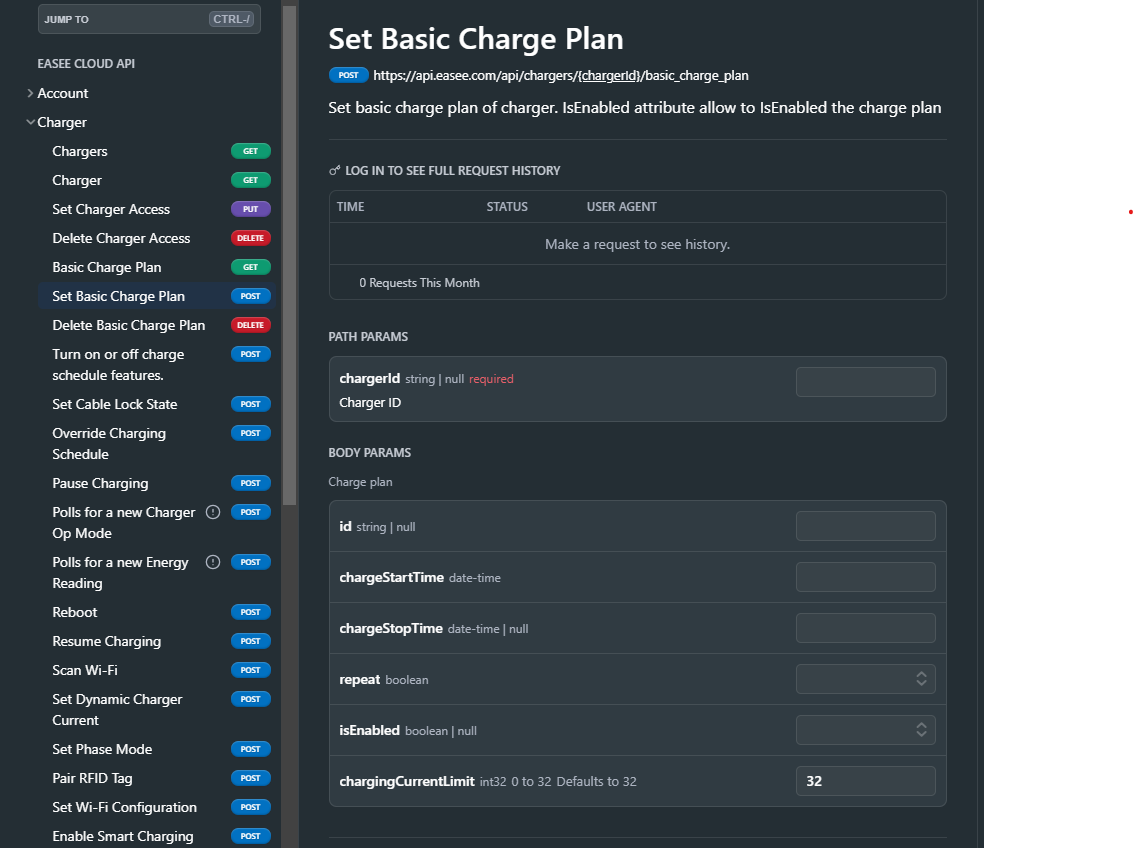

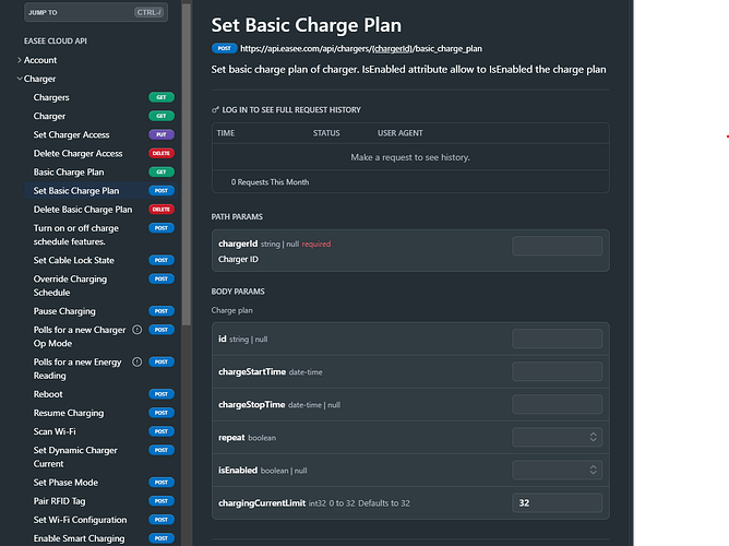

I’d like to request for a feature to implement ā€œSet Basic Charge Planā€. At the moment I use OH to schedule to charge during off peak hours (based on lowest EL price), and then when the time comes OH sends ā€œstart chargingā€ command. It used to work rock solid until Autumn but since then it became unstable. I observed the case that command was sent but charging didn’t start. I have a retry in my rules to send 5 times but even thought it failed multiple times.
The ā€œSet Basic Charge Planā€ as I understand will set a delayed charging in Easee, so the timer is controlled by Easee, which I’m hoping more stable. Furthermore it allows to set a range so that stop charging at expensive hours is also possible. Appreciate if you can consider in the future version.
