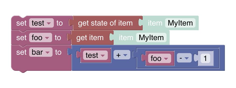

In fact, I cannot get either the Item block nor the “get state as Item” block to dock to the + operator block. But I’m running OH 4 snapshots and Blockly has had a ton of work done since January. In order to dock them to the addition block I need to assign them to a variable first. But that causes them to lose their type meaning I can dock any variable to the addition block.
var test, foo, bar;
test = items.getItem('MyItem').state;
foo = items.getItem('MyItem');
bar = test + (foo - 1);
Note that because I’m on OH 4 snapshots, Blockly “compiles” into JS Scripting ECMAScript 2021 instead of Nashorn JS Scripting ECMAScript 5.1 so the code will look different.
