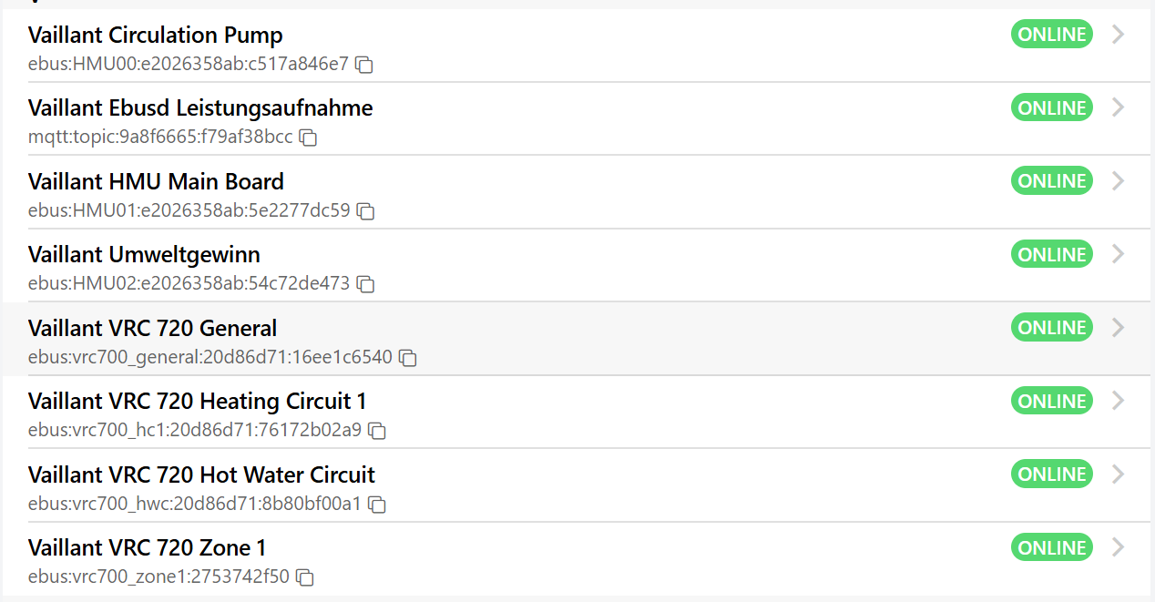

Hi, can you give some more insides how you managed this . I have already a ebus shield c6 hardware and also a Vaillant Therm, but not sure how to configure this binding with any config file. Thanks a lot.
Am not sure if i understood what you are exactly looking for? Maybe this thread can help you:
If not, feel free to contact me again.
oh wow this is impressive - I just need to get my ebus adapter to be connected - as it ist in my owned neighbour house and I have to switch off power first. Thank you anyway and I may come back to you.
Hi, so finally I have connected my ebus shield c6 to the bus - installed ebusd on my raspberry pi 4 - and the binding and bridge on OH - finally I managed that I get the number of recieved telegrams reported, but the things / channels of any VRC700 object does not show any result.
The adapter is connected via USB to the raspberry (/dev/ttyACM0) but I could not get the USB to transmit values so I switched back to the WLAN version. Anything which needs to be adjusted in the binding or the things ? . ebusd is currently not running on the raspi. Thanks a lot for any help :slight_smile:

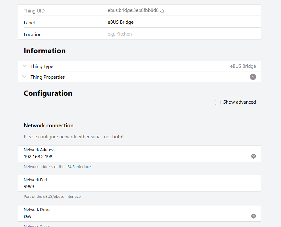

I have my ebusd adapter disabled in openHAB because my production coupler is an Esera LAN eBUS adapter. There are two ways of connecting to the ebusd adapter:
  1. Directly via WiFi, port and using network driver “raw”.
  2. To a computer which already runs the ebus daemon using the computers IP and port and then the the ebusd network driver. For this, some environment settings are required (see below).
Onyl way 2. enables the full advantage of ebusd (zero roundtrip time).

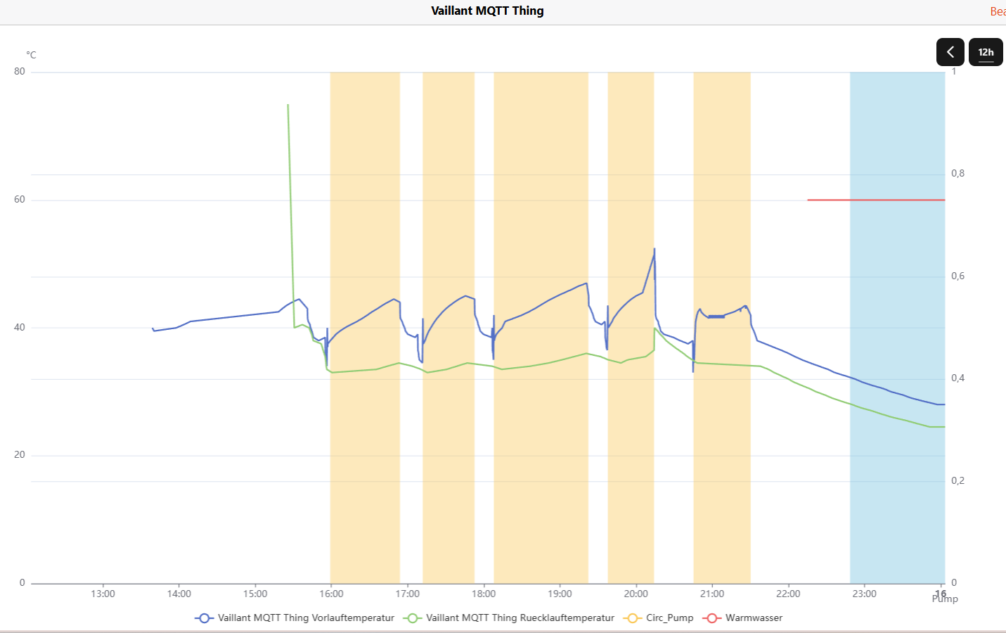

I finally want to update that I managed it, but not with the ebus binding - this made me headache with all the things which didnt work in my setup.
I switched over to MQTT which works now perfekt as far as I see - the edbus.service file needs to be updated in the ExecStart= line so that mqtt is in service - than you can easily grab the published values of the MQTT State Topic via a mosquitto broker and then use the MQTT bridge.
Create a generic MQTT thing and then the appropriate channels e.g heating water → at a link as item and then you have it in openhab
again thanks for your time and help
