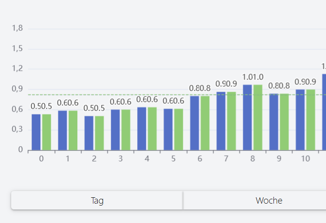

Not sure this is another small bug…
oh-aggregate-series smallest timeblock to display is 1h → that’s why I created 2 influx “measurements” = series for testing purposes:
  • measurement 1: Sampling 1 minute
  • measurement 2: Sampling 1 hour
aggregationFunction: diff_last for both series.
I wanted to be sure Sampling 1h is sufficient (it should be) and would lead to exactly the same bars, irrespective whether charttype is “year”, “month”, “week” or “day”.
The good news are that the bars seem to match EXCEPT for the very first timeblock being the first hour of the period to aggregate.
Sampling 1h leads to value 0 in hour 0. (IS THIS A BUG?)
There is definitely data prior to hour 0 to which the aggregationFunction: diff_last can be applied to.
That missing value impacts “week” and “month” on the FIRST DAY displayed.
In type “year” the month of January would also be impacted, however, that missing hour is not visible.
The 0.7 kWh that are missing in hour 0 (upper chart) seem to be the difference on day 1 with 21 vs. 20 kWh (lower chart9).

No, except for the aggregation one level above the current level (i.e. if you want the sum for all hours of the day, choose a aggregation by day and display weekly/monthly charts).
That data from 23:00:00 isn’t fetched, as the chart starts at 00:00:00.
We need the UI to request the data for the previous time block so it can properly calculate.
I’ll look into this.
