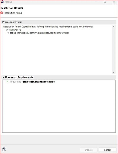

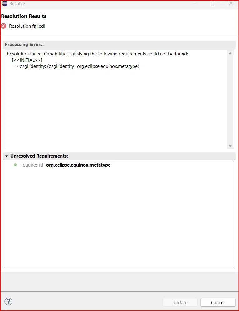

Eclipse - can't resolve: org.eclipse.equinox.metatype not found
I’m trying to run debugging in Eclipse, and once again, ‘resolving’ fails. This time the culprit allegedly is org.eclipse.equinox.metatype.
I tried searching the forum for help, but didn’t seem to find anything on the topic.
Does anyone have an idea? I’ve pulled both the core as the addons repository, so all is up to date.
PS! Read the last edit first, there’s no point in wasting time on this if you’re running the wrong version of Bndtools.
Don’t mind the error itself, they rarely point to something of interest.
The most important thing is to make sure that “everything is up-to-date” before you try to resolve:
