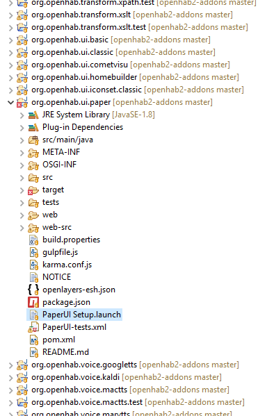

Eclipse IDE PaperUI missing
Right-click, Run As → PaperUI Setup
It took about 15 minutes to run and complete here - just let it do its thing.
Yeah, just found it after posting. It’s running, and running, and running… :sunglasses:

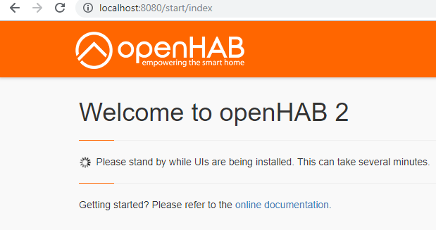

What I can not understand if you can run a new installation running on Eclipse IDE, up to 2 days ago the UI did not work.
I need the installation to take the development and debug a binding.
What can you suggest?
Today I tested this and got a working Paper UI in Eclipse.
I did need to update the launch configuration with the changes in PR #885.
I tried a new installation with Latest Release (2018-12)
No duplicate Equinox bundles anymore
PaperUI not work
