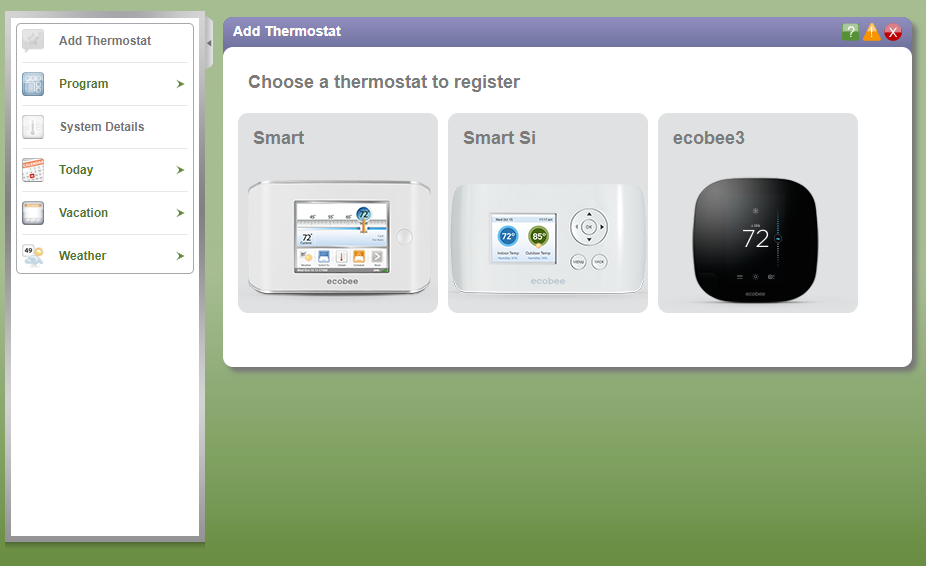

I go to Smart Thermostats & Smart Home Devices | ecobee, and sign in the upper hand corner. Once I login it goes to https://www.ecobee.com/home/secure/heatingAndCooling.jsf, which appears is what I get with the original smart thermostat. Once I log in I can go to https://www.ecobee.com/consumerportal/index.html and get the new portal. I also found a way to get to if from the old portal:
Select Add Thermostat to open the thermostat panel and select ecobee 3:

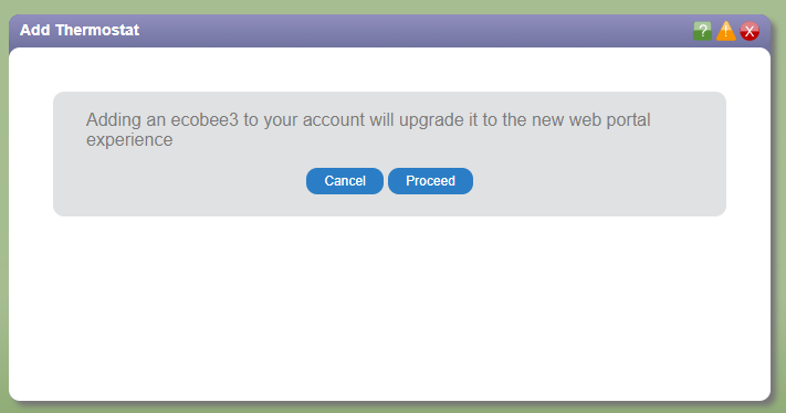

Then select Proceed:
This switches to the new portal, press X on the ADD THERMOSTAT panel, and then I get the new portal. If I log out and back in. I’m back to the old portal.
Using either approach, I was able to complete the steps in the documentation and got it to work again.
